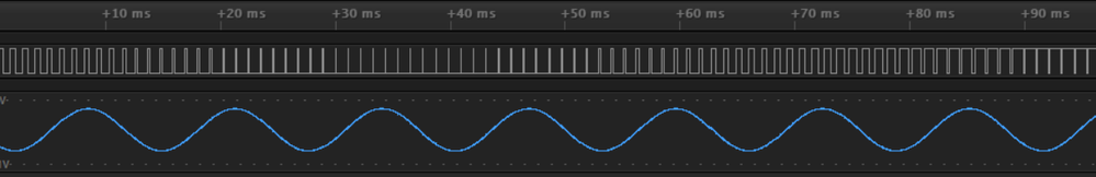

I'm working on an SPWM (sine wave pulse width modulation) setup in which a block of memory is written via DMA to the CnV register of a FTM (FlexTimer Module).
I have a setup in which no DMA is used and the FTM duty cycle is updated in the main loop (very dirty). This arrangement works fine but consumes a lot of CPU cycles that I would rather use for other things. The FTM CnV buffer is written to the register when the API (https://mcuxpresso.nxp.com/api_doc/dev/974/group__ftm.html#ga08e1b1c36631d42a77a5e08d76884d8b) function
FTM_SetSoftwareTrigger(FTM_0_PERIPHERAL, true);
is called.
The DMA setup shows no error flags in the DMA error status register, so I'm reasonably confident that it is set up ok. However, when I connect the DMAMUX to FTM CnV channel and try to run the FTM with CnV updates via DMA the FTM duty cycle is fixed at its initialisation value.
I suspect there is an option register in the FTM that I'm not setting which tells the FTM to ask the DMA for the next CnV value and update the CnV register from the buffer when the FTM counter rolls over. I am aware of the DMA bit in the FTM CnSC register but I think there must be a hardware trigger bit that I need to either enable or have the DMA fire when it updates the buffer.
Any assistance would be much appreciated.

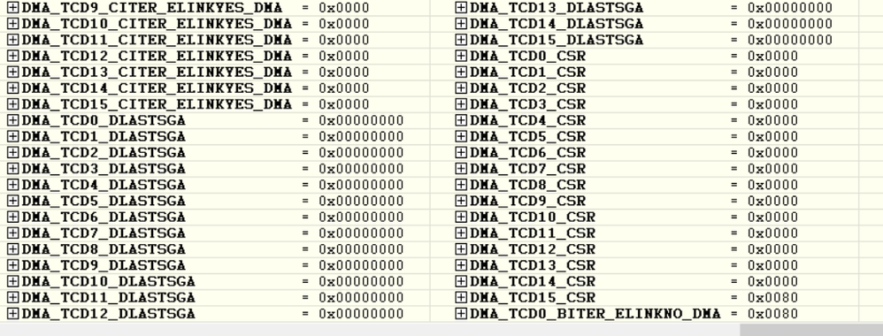

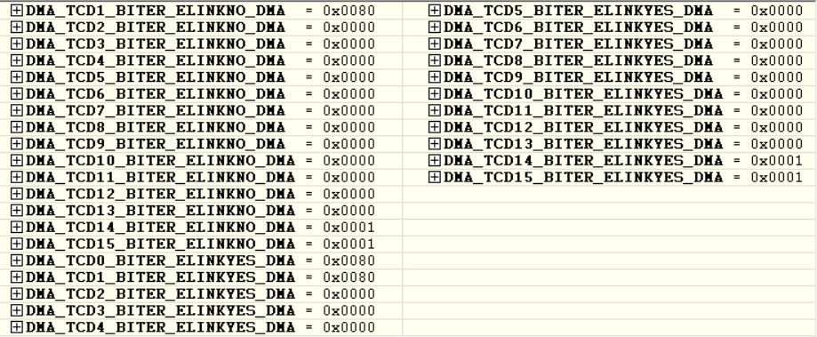

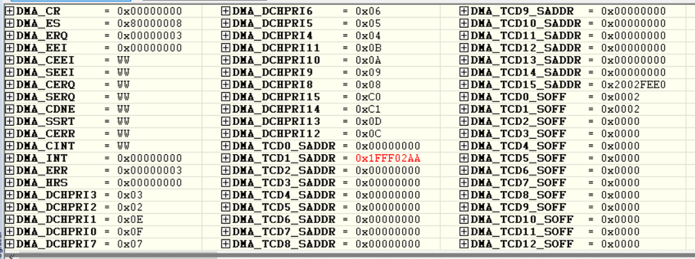

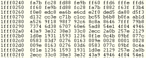

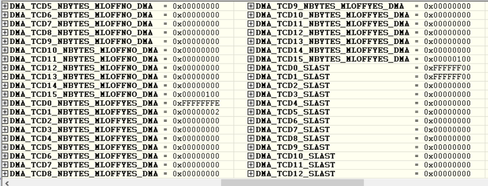

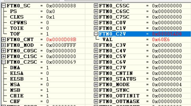

To make to easier for you to reverse engineer the method that I set up for you I have some screen shots of the registers involved:
DMA channel 1 is used and the DMAMUX is connected to the FTM0 channel 2.
These are the FTM registers of interest:
DMA controller registers (snap short when operating) - channel 1 of interest (channels 0 and 15 are also in operation but can be ignored)
This is the block of memory that the DMA channel 1 source pointer is using, where the SINE PWM pattern can be seen:
If you compare with your setup (and interpolate for the channel and trigger source you are using) you may find a difference that explains the problem. As noted previously a typical mistake is not not set the CHIE flag in the FTM channel register when using DMA because BOTH CHIE and DMA flags need to be enabled for the DMA trigger to operate.
Mark

Use your debugger and pause your (not yet working) code when it "should" be generating the output but is only generating a fixed PWM signal.
Then compare the registers that you see with the ones that I have shown to see what is different/missing - then you can correct your code appropriately (you will probably find just one flag that hasn't been correctly set).
If you have no success, post your binary file that should be generating the signal (no need for any source code) so I can load it to my FRDM-K64F and then tell you why it is not operating as intended.

And this is the output on PTC3 (FTM0 channel 2) - the top is a PWM signal following a SINE wave (from 0..100% PWM repeating each 100ms or so).
The code also generates a sine wave on the DAC0 output using PIT triggered DMA which is however independent of the SPWM (the frequencies are also not related)
As you probably know already, the sine wave in the table has to be calculated in a way that is dependent also on its frequency since the sample rate is defined by the PWM period (if the PWM period is changed the table needs to be recalculated, as is also the case when the sine wave amplitude is changed).
I just set the table to vary as a sine from almost 0% PWM to 100% PWM with a max. MOD value of 0xffff (PWM period) without pre-scaler set.
Such things are very simple to do (and can be simulated with the uTasker Kinetis simulator which also accurately simulates the peripheral DMA operation) but in your case it may be that you have not enabled the Flex Timer interrupt (which needs to be enabled together with the DMA mode for it to work).
Beware also to not have the value 0 in the PWM table since a zero will generate 0% PWM output but will not cause a match to take place, which will stop any further DMA triggers....Note that I set 1 instead of 0 to ensure it can't stall (sine wave generation routine)
You can connect a debugger to the board and pause it - the two Sine outputs will continue to be be generated when the CPU is halted. Then you can check all Flex Timer and DMA register setup to identify what is different to your configuration.

I have attached a short video of the simulation of the SPWM DMA operation.
When the mouse is hovered over PTC3 (the PWM output) the present frequency and PWM value is displayed. When the DMA operation is generating the sine wave the PWM can be seen to be changing accordingly (PWM is not fully real time but the operation can be accurately verified and any DMA errors also quickly identified and solved).
