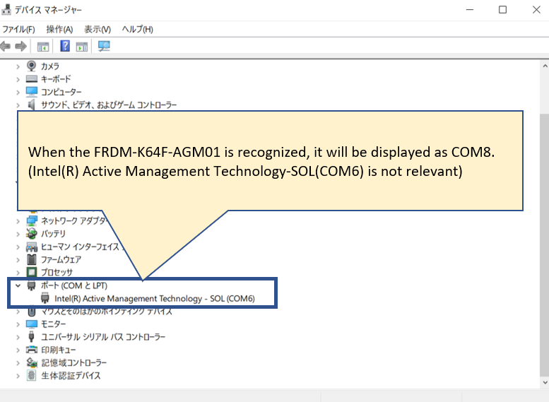

I have encountered a problem while trying to perform an evaluation test on the product below.
Product model: FRDM-K64F-AGM01
Problem: The dedicated installer (The Freedom Sensor Toolbox-Community Edition (STB-CE)) does not recognize the product even if the FRDM-K64F-AGM01 and the computer are connected via USB.
Currently, we have downloaded what is required to install STB-CE.
(Visual C++ Redistributable for Visual Studio 2012 ,Visual C++ Redistributable for Visual Studio 2013 ,VISA Runtime Engine 17(124MB), LabVIEW 2017 32-bit Runtime Engine(366MB) ,Microsoft .NET Framework 4.0)

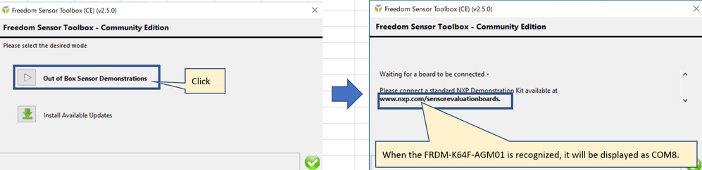

First, start the installer (Freedom Sensor Toolbox-Community Edition (STB-CE)). Then click "Box Sensor Demo" as shown in the figure and connect the PC and FRDM-K64F-AGM01 with a USB cable.
When FRDM-K64F-AGM01 is connected to a PC, it will not be recognized as a port by the PC's device manager as shown below.
At this time, there is no change in the appearance of FRDM0K64F-AGM01.
Furthermore, even if you press the RESET button of FRDM0K64F-AGM01, it is not recognized as a port in Device Manager, and there is no change in The Freedom Sensor Toolbox-Community Edition (STB-CE).
Furthermore, even if you change the PC (Windows7, Windows10) and install and connect The Freedom Sensor Toolbox-Community Edition (STB-CE) again, the same phenomenon occurs even if you change the USB cable.

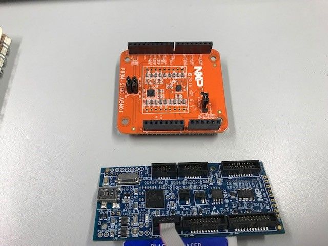

t-kira
Thank you for your reply.

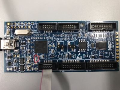

The debugger I purchased this time is the one shown in the figure below.
I bought this debugger from the link provided.
The figure below shows the connection between the PC, debugger, and board.
The board connection is J10 pin.
We apologize for the inconvenience, but thank you for your reply.
8,984 Views
nxf56274

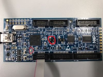

When you connect the debugger to PC, this led should light. I made a red circle. Please check.

As you can see in the photo above, when you connect it to a PC, the LED lights up as shown in the figure below.
However, the same screen as last time is displayed.

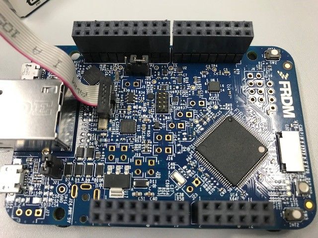

8,976 Views
nxf56274
Use a jumper to connect R46, I made a big red circle. 
Jumper is this.

t-kira
I used a jumper to connect the R46 on the board to the debugger, but the same screen as last time is displayed on the PC, and the problem has not been solved.
The figure below shows the jumper settings used for this connection.
Is this jumper setting correct?
