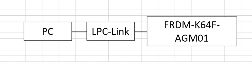

t-kira
Thank you for your reply.
I heard that the PC and FRDM-K64F-AGM01 can be connected with a debugger.
However, I think FRDM-K64F-AGM01 is for connecting directly to a PC.
I want to connect to a PC with only the following two boards.
What do you think is the reason why the board and PC in this figure cannot be connected?
We apologize for the inconvenience, but thank you for your reply.

t-kira
In other words, should I purchase LPCLink and use LPCLink in the diagram below to enable the connection between the PC and FRDM-K64F-AGM01?
5,700 Views

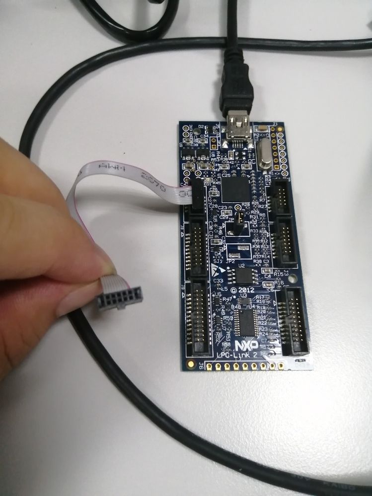

nxf56274
This is LPC link. You can use it to debug.
TIC

t-kira
I'm sorry, I made a mistake in replying, so I am sending it again.
About Debugger I looked up FRDM-K64F-AGM01 and the corresponding debugger at www.segger.com. Should I buy the debugger shown in the figure below?
If the LPC link in the previous figure is connected to J10 on the board, what I connect to the other side?
I am sorry for many questions.
please tell me.

nxf56274
Do you have the debugger? You should use debugger and connect to the J10 on board. Then follow the document.

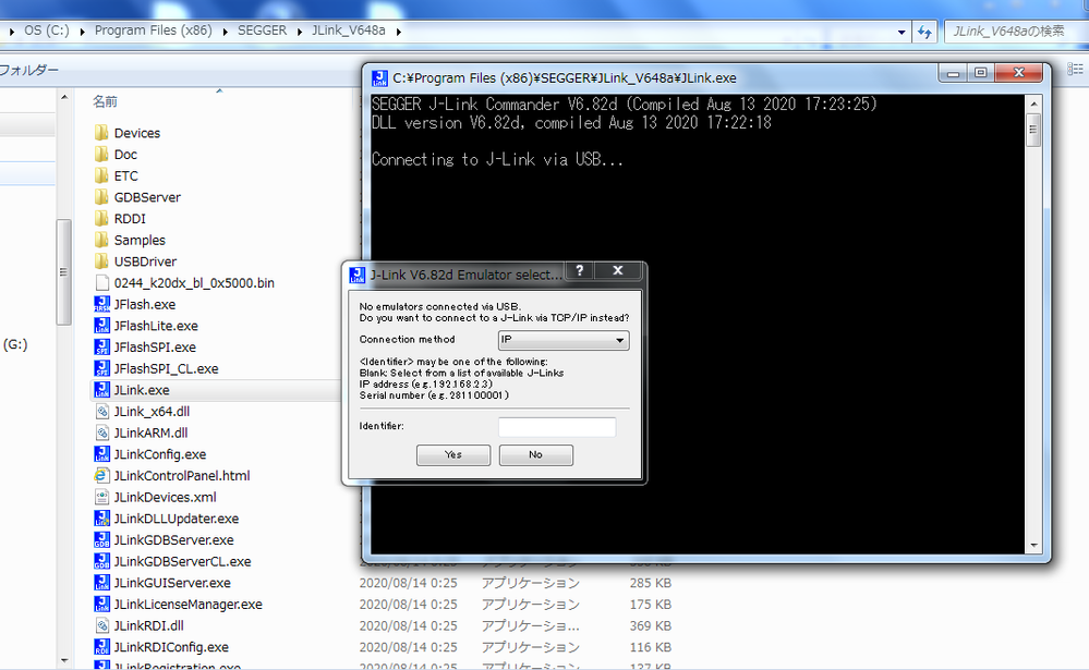

t-kira
I experienced the debugger for the first time.
As I told you earlier, I downloaded "J-Link Software and Documentation pack for Windows", connected the PC to the board in step 5 of the attached file, and clicked "JLink.exe" in step 6.
You will see a screen like the one shown.
A similar screen is displayed by pressing the reset button on FRDM-K64F-AGM01 and clicking "JLink.exe". Even if I check the connection of the USB cable or use another USB cable, I cannot connect in the same way.
After all, is it a malfunction of the USB connector of FRDM-K64F-AGM01?
I tried variously, but is there a workaround?

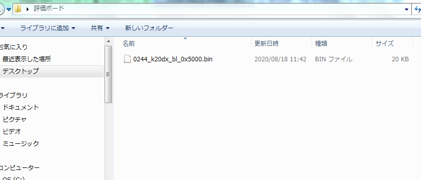

t-kira
I saw the attached file.
I downloaded "OpenSDA version/bootloader" in steps 2 and 3 of the attached file and placed it in the folder I created.
However, as for how to download the JLink application, I saw the link in the attached file, but I could not understand what to download.
Can JLink be downloaded for free at www.segger.com in Links?
I'm doing a JLink search on www.segger.com, how do I find the JLink I'm looking for?

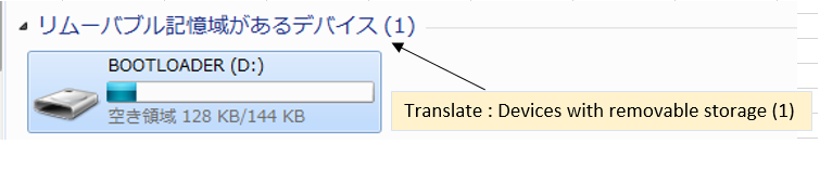

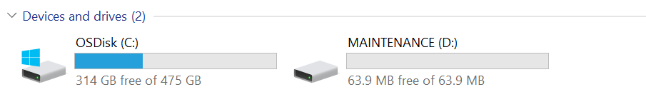

t-kira
Thanks for the reply.
I inserted the cable many times (the USB connector next to the reset button on the FRDM-K64F-AGM01 and the USB cable connection, the USB cable and the PC connection), but the same phenomenon as the previous mail occurred, so it is correct It seems that it is plugged into.
FRDM-K64F-AGM01 (USB connector next to the reset button) is connected to the USB cable and the USB cable is connected to the PC.
When I pressed the reset button of FRDM-K64F-AGM01 in this state, "BOOT LOADER (D :)" was displayed on the PC.
I do not know the cause, but is the FRDM-K64F-AGM01 USB connector itself damaged?
We apologize for the inconvenience, but please reply.
5,580 Views
nxf56274
Do you insert the cable correctly? The usb connector beside the RESET button is what we use. When you press reset without releasing, does the PC show the disk like 'bootloader" or "maintenance".
If not, use jlink to connect MCU(J10), try to connect with the debug MCU mk20.
If so, you can update the firmware and try it again.
