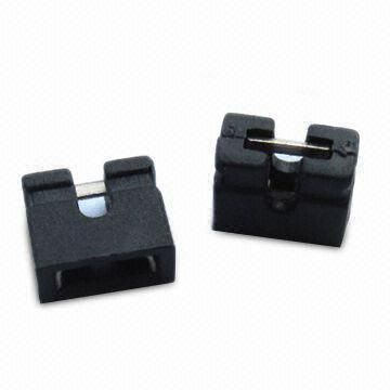

Use a jumper to connect R46, I made a big red circle. 
Jumper is this.

t-kira
Thank you for your reply.
I used a jumper to connect the R46 on the board to the debugger, but the same screen as last time is displayed on the PC, and the problem has not been solved.
The figure below shows the jumper settings used for this connection.
Is this jumper setting correct?
We apologize for the inconvenience, but thank you for your reply.
