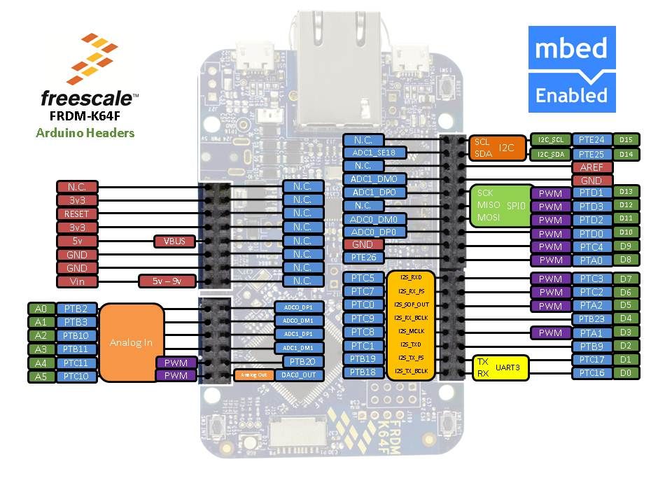

The FRDM-K64 is fully compatible with the Arduino rapid prototyping system, the following image depicts the board's pinout, the green labels can be used directly into your mbed proyects, they have already been defined in the headers and libraries in order to make development easier.
