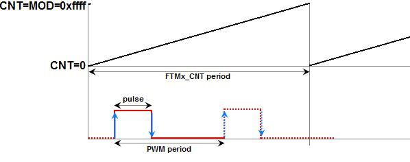

yuanhanchen
I am trying to measure the percentage of a PWM signal on a FRDM-K64 board. I am using the FTM2 FlexTimer in dual edge capture mode on channels 0-1. I'm getting the interrupts both for the rising and falling edge of the pulses.But after entering the interrupt function, simply enter a rising edge of a subroutine, but there is no falling entered a subroutine, why is there such a situation

Robin_Shen
Yes, that code doesn't take into account the case of FTMx_CNT overflow.
So if you want that code get the correct result, you need ensure FTMx_CNT doesn't overflow.(FTMx_CNT period > PWM period)
You can increase the overflow period of FTMx_CNT by setup "ftmInfo.prescale".
If kFTM_Prescale_Divide_1, then pulseWidth = ((capture2Val - capture1Val) + 1) / (FTM_SOURCE_CLOCK / 1000000);
If kFTM_Prescale_Divide_128, then  pulseWidth = 128*((capture2Val - capture1Val) + 1) / (FTM_SOURCE_CLOCK / 1000000);

yuanhanchen
Hi Rbin_Shen,
Thank for your help,I've looked at your code, I also had a look at this example, the code for this but there is a problem, this code does not take into account the case of overflow interrupt, and overflow interrupt calculated according to the desired value in the first interval along the overflow interrupt flag is set to 0, so it is necessary in the first direction to generate an interrupt, but I list the code shows: generate interrupt flag is wrong, but why is wrong. Can you help me?

egoodii
Senior Contributor III
Yes -- as long as capture1Val and capture2Val are declared as 16-bit unsigned, and FTMxCNT is 0xFFFF (full 65536 counts)., and then you CAN IGNORE OVERFLOW.  For THEN a pulse (not clear if user is looking for 'high time', 'low time', or 'full pulse time') that happens to fall across an 'overflow time point' will get the proper mathematical result:  For example, 1 - 0xFFFF in 16 bit math is a proper 2, in 32bit it is 0xFFFF0002.

egoodii
IF that 'ftm_dual_edge_capture' demo code had defined capture1Val and capture2Val as uint16_t, (and only allowed the promotion to 32-bit math in the '+1' operation)  then the 'natural' 16-bit-integer math would preclude any requirement to worry about 'overflow' as long as the overall pulse width to measure is less than one full FTM cycle.
