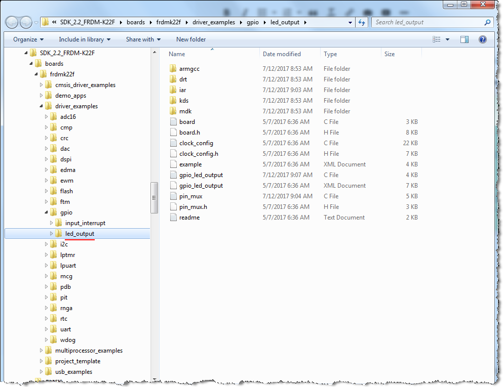

Please download the SDK_2.2_FRDM-K22F package refer Generating a downloadable MCUXpresso SDK v.2 package.

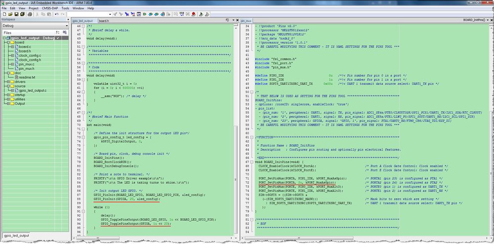

Then you can modify the led_output example to toggle the Green LED.
