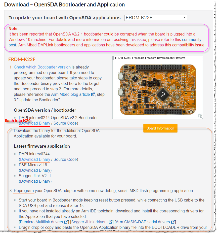

After looking into many issues I downloaded the opensda bin file to my board and it stopped working.
When I push the reset button while connecting the board there's also no response in any way.
   Is there any way to restart the whole board?
I attached the file just for information(be careful, after downloading the file into the board it appears to kill it).

Hi edgardnetz,
It has been reported that OpenSDA v2/2.1 bootloader could be corrupted when the board is plugged into a Windows 10 machine.(You can find the information at OpenSDA)
If you are using Win10, you may need to use external Programmer Flashing the Bootloader into K20.
And then Reprogram your OpenSDA adapter with Lastest DAPLink rev0244 firmware application.

After checking the links, does this means I'm gonna have to buy another FRDM board to be able to program this board?? or a separate programmer?
Unbelievable
2,806件の閲覧回数
Robin_Shen
If your board give no response in any way on other PCs, then the bootloader may have been corrupted. I am sorry to tell that you may have to buy(or borrow) another FRDM board or separate programmer.
