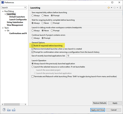

Is there a way to generate a new .axf file for every new debugging session without deleting it manually?
Why do you want to do this? The Image info is the same if you just re-link the application. But you could add a custom script as pre-build to touch a file or delete the .axf, then have the debugger to run a build first, see https://mcuoneclipse.com/2012/10/30/speeding-up-the-debug-launch-in-codewarrior/
Here is how the pre-build for MCUXpresso IDE: https://mcuoneclipse.com/2021/03/24/touch-build-auto-update-of-firmware-date-and-time/
