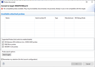

   I've been trying to run the debug on  the FRDM-K64F, but the following error appears:
    The debug was working fine before this. I install the MCUXpresso IDE again, but the error is still appear. I am using MCUXpresso 11.2.1 and Windows 10.
    Looking forward to your feedback. Thank you!

HI @Yilia
I would suggest you try to do a probe discovery by holding the SHIFT key while launching a debug session from the Quickstart pannel. If the new debug connnection is completed, a new project launch configuration will be created replacing any existing launch configurations.
