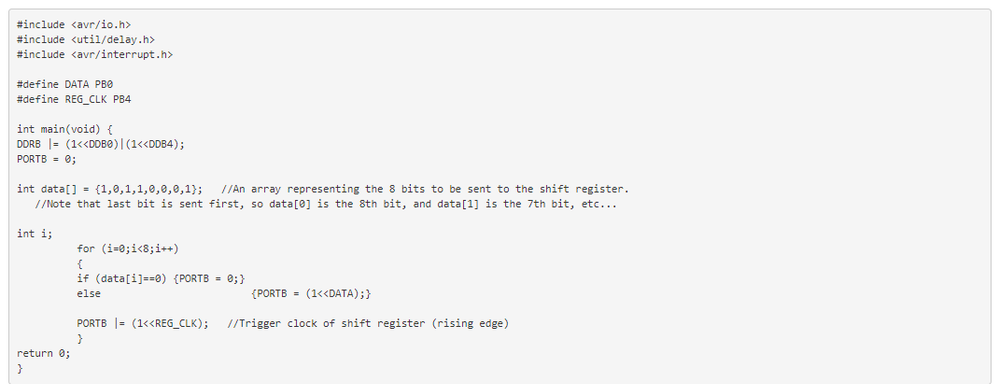

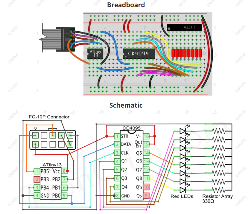

Below this statement is how it would be connected, IF, I was using an ATtiny 13.
Also included is the code for the ATtiny below that.  The syntax used to create the array I assume is different than in KDS.  My biggest problem is correctly writing the code PRIOR to "int main(void) {...", i.e. initializing the array,
followed by what to write within  "int main(void) {...}" in order to use the array.
I did try, however, I haven't been successful.

It may be an issue with the compiler C programming language standard dialect (eg. C90, C99, C11) used by KDS (it may also be configurable if you play with it) that will not allow you to declare variables in a routine after code.
If you do this instead it may build:
int main(void) {
int i;
int data[] = {1,0,1,1,0,0,0,1};
DDRB |= ((1<<DDB0)|(1<<DDB4));
or if you put the second part in brackets it may also be OK:
int main(void) {
        int i;
        for (....
I would also make int data[]
static const int data[]
to keep it in flash.
Also, the array looks to be a bit overkill in this case whereby
static const data = 0xb1;
for (i=0x80;i!=0;i>>=1) {
    if ((data & i) == 0) {PORTB = 0;}
    else {PORTB = (1<<DATA);}
    PORTB |= (1<<REG_CLK);
is both more efficient and more logical "when thinking in the byte value" to be sent.

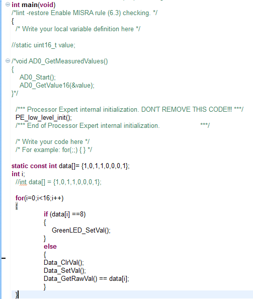

Hi Mark,
Thanks, that's put on the correct track.
I now see me clock signal that I created.
I would like to output each value in the array on PT1 but I'm not sure how to do that.
Here's what I have so far in my code, I'm not comfortable with my choice taking data[i] and passing it to Data_GetRawVal().
I've tried others but still not sucess.

I am sorry but I don't follow your code:
1. data[] has a size of 8 ints but your loop is using 16 entries and so over-running the end of the array.
2. data[i] (when i is in valid range) can be either 1 or 0 so the if (data[i] == 8) can never be true.
3. Data_GetRawVal() == data[i] is comparing the function's return value with the array entry but the compare is useless.
Check the console output when you compile this since I would expect the compiler to already generate one or two warnings due to this.
Run lint over the program and it will probably give half a dozen warnings.
