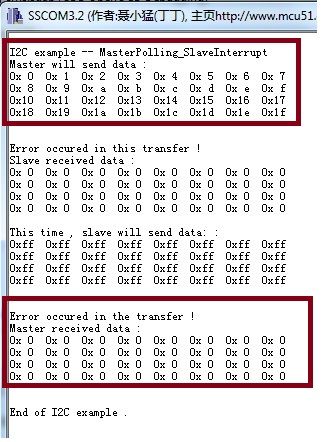

Now I am using  FRDM-K22F, I2C polling_transfer example of V2.0 SDK example code. My understanding is that, I2C0 work as master to do write/read three-axis accelerometer(slave device). Normally the content of writing and reading should be same, but they don't match as below picture. why?

Hi Kent,
Please remember you are writeing/reading peripheral instead of memory. When accessing peripherals like accelerometer, you are accessing its registers, you cannot gurantee write/read result is the same.
Which specific register you are trying to access?
Hao

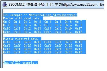

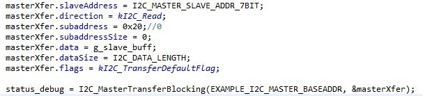

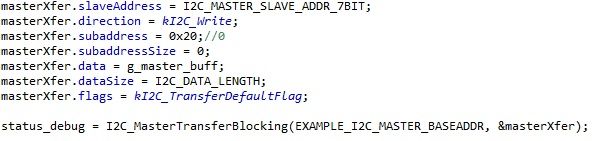

  • Now I switch to my board using, use K2FF read STM24128 I2C E2PROM chip , use I2C polling transfer demo example, just keep master section.
//Write
//Read
Writing and reading both action work well because the function return 0, but seems that write and reading data is not same.  Seems that reading data is initial data in E2PROM because all data is 0xff. It means that we don't sucess in writing data to E2PROM?
  • Cutworth: The I2C address of course should  changed to the device address you use like 0x1C on FRDM board.
Kent:Now I use the STM24128 I2C E2PROM, address is 0(E0,E1,E2), and then  the device address is 0x00? I don't know how to define it?
  • subaddress of I2C EERPOM, should no require for the value? Just make sure it is in the EEPROM space,  data length is not bigger over EEPROM space.
  • subaddressSize,  8bits register use 0,  16bits register use 1?

kent_gu
Have solved the problem:
#1, Device address, need to define base on your chip for application.
#2, subaddressSize, it is device subaddress length, such as1 byte device sub address, subaddressSize is 1; and such as 2 byte device sub address, subaddressSize is 2.
