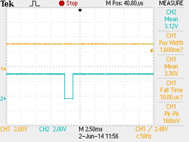

Regarding the binary code which is attached in your reply: I dumped that code on probing on PORTC11 (int1) and PORTC6(int2), I got the following trace
channel 1(yellow) is connected to PTC11(INT1), channel 2 (blue) is connected to PTC6(INT2).
I can see the green LED blinking.
The output from the terminal window is coming once i.e.
Please guide me for next steps . Thanks

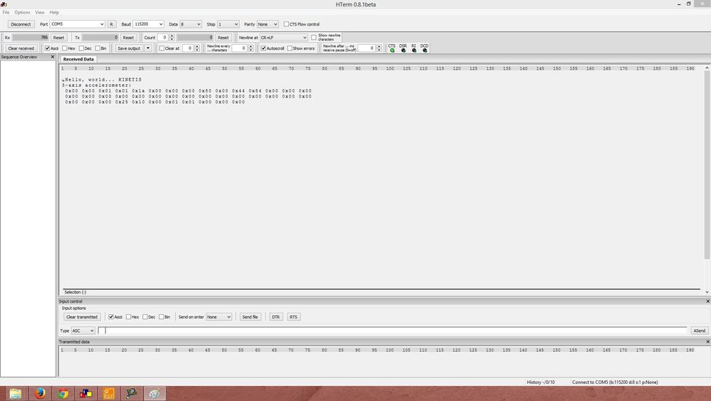

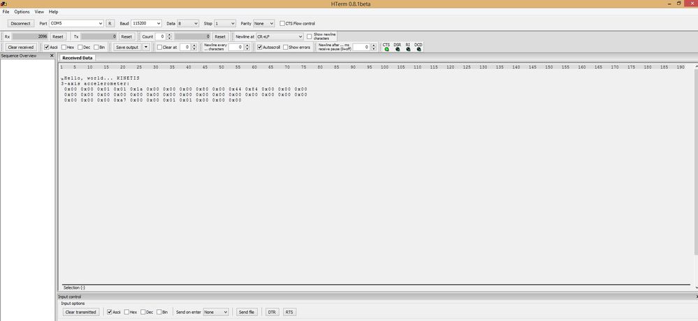

Amit_Kumar1
Senior Contributor II
Hi Mark
After loading the code initially I didn't disconnect the board, so after disconnecting and reconnecting the board I got the following waveform Channel 1(yellow) is INT1(PTC11) and channel 2 (blue) is INT2(PTC6)
and on resetting the board through the reset switch I got the following o/p in terminal window
But the o/p came only once. Now what you suggest for me to do next.?

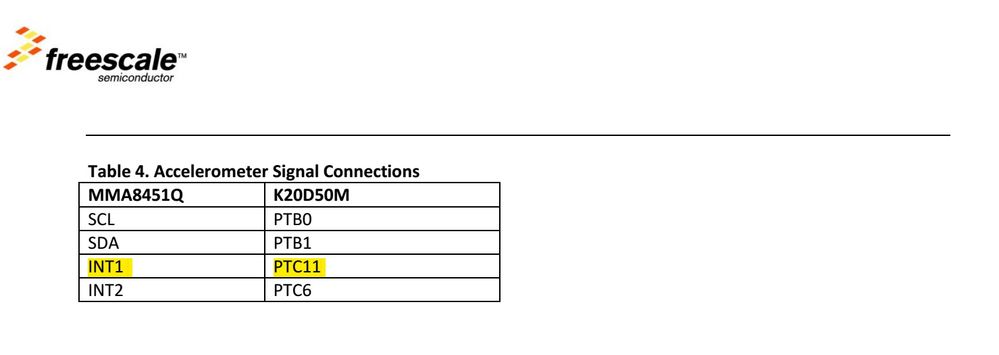

mjbcswitzerland
Specialist V
Hi Amit
In your diagram channel 2 (blue) is INT1 (PTC6).
You should find that the pulse repeast every 20ms (50Hz) whereby the pulse width is the time until the data is read via I2C, resetting the interrupt source
If you hit the enter key on the debug port you will see a menu - there is an I2C sub-menu (eneter the menu number 7 plus return to move to it) where you can command "acc_on" so that the values are displayed every 2 seconds - "acc_off" to disable.
In the case of your code I don't know wheher the interrupt is being handled or whether the data is not being read correcly so that the interrupt is not being cleared - this will require you verifiying these two points to idenify what is not happening or what is not correct. As reference I can show the code that is running in the uTasker project. This is using an interrupt driven I2C driver and a simple OS so the code is based on a simple state-event machines. You should get the idea and can certainly verify the I2C messages being used. Perhaps you notice something.

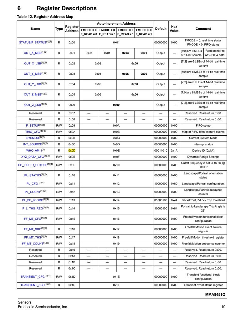

Thanks for the code. Many things are cleared now . I had some queries regarding my code.
1. Plz check the configuration of the I2C if it is matching with yours. As once I had issue with a gyro that I was trying to operate at higher frequency and at that frequency(500KHz) I was getting the value WHO_AM_I register correctly but was unable to configure other registers and get the readings out. when I changed to 180KHz then it worked fine. I don't know with this accelerometer.
2. In the datasheet, for each register 2 register address is given (Register Address and Auto-Increment Address). Here I am using Register Address. am I reading the correct register address? I checked with the WHO_AM_I register It i giving the correct value on 0x0D register.
Amit Kumar

Amit
It is possible to read with up to 400kHz I2C clock.
In the uTasker code 8 bit mode is used and so F_READ is set to 1 so that the read of 4 bytes from the address 0x00 causes the values from 0x00, 0x01, 0x03 and 0x05 to be returned, and the internal pointer automatically be set back to 0x00. This avoids having to set the internal pointer again each time a read is performed.
Mark

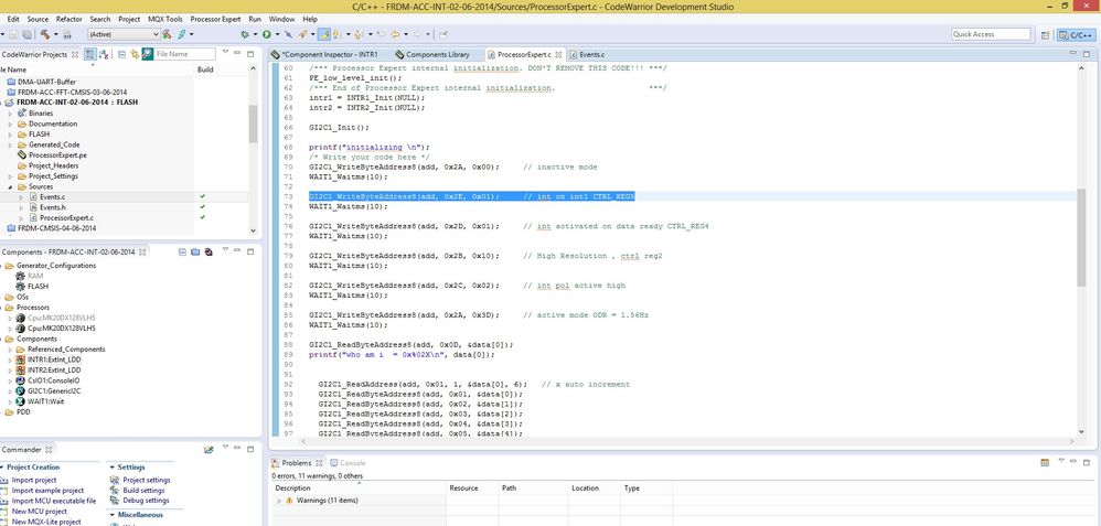

Amit_Kumar1
Hi Mark
I thing there is a huge bug in Processor Expert software. While debugging, my code is hanging in the interrupt initialization. I think I have done all the things as per the specification given in the datasheet and it shouldn't be so difficult to configure an interrupt driven accelerometer using I2C. I think processor expert team should go through the components as I am making this code run on a standard h/w FDM-K20D50M. and more importantly your code is working on it. So I guess there are some issues with the PE itself. Attached is the code where during the initialization my program is hanging on interrupts.
Kind Regards
Amit Kumar

Amit_Kumar1
Hi Mark
I am extremely sorry for the inconvenience. Please have a look at the attachment attached in this reply. Also I tried extracting the data using GI2C1_ReadAddress(add, 0x01, 1, &data[0], 6); where
add = 0x1D (Acc address)
0x01 --> MSB_X address
1--> size of MSB_X_Address in bytes
data--> uint8_t data[6];
6--> total no. of elements in  the array(to be extracted)
Using this function I am not getting the exact data which I am getting when extracting each address individually.

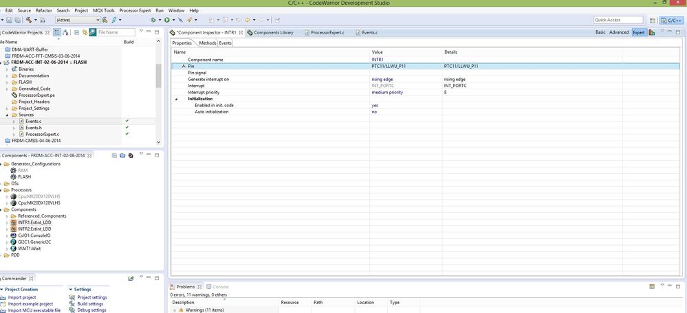

For the interrupt pins I tried disconnecting the board and reconnecting it (for power on reset) but still my code hanged in interrupt pins initialization function.
9,962 Views
mjbcswitzerland
Specialist V
Amit
I checked your code.
The first problem is that INTR1 and INTR2 are incorrectly defined. INTR2 is in fact INT1 on the board (or from the accelerometer) so the wrong interrupt routine is being used.
If you use INTR2_OnInterrupt() instead of INTR1_OnInterrupt() the interrupt arrives.

Hi mark
I tried with the changes u mentioned i.e
1. I changed the interrupt1 pin to -->PTC6.
2. Changed the falling edge to rising edge and checked.
in case of rising edge my program is still stucking in the  intr1 = INTR1_Init(NULL);
Can there be a hardware issue? I checked J16 and J17 as u mentioned in earlier post. I am attaching the updated program which was supposed to work according to you. Check if it is working in your hardware.
Amit Kumar

Hi Mark
one more Issue I had which I mention above . i.e GI2C1_ReadAddress(add, 0x01, 1, &data[0], 6); is not working
I wanted to extract the x,y,z values using auto increment function. currently I am extracting all the values one by one. In auto increment the value being received does not match with the values extracted individually. I tried with little Endian configuration which our uc is.
Please Check the issue. Thanks in advance

mjbcswitzerland
Specialist V
Amit
This use in incorrect and also results in a warning when compiled. The read address parameter must be a pointer to the address (this is not logical but that is the way that the routine is defined). I would also suggest reading 7 bytes from address 0 so that also the status register is read - but don't know whether that makes any difference in regards to resetting the interrupt or not.
Please note that I don't work for Freescale and so if you believe it is worth requesting a correction in the user's manual to the board you can create a service request so that it doesn't get overlooked. Also I don't use PE for my own work but support cases to get to know problems that people have with such work (typical usage, typical board problems, typical peripheral difficulties, typical mistakes, etc.) so that I can better support uTasker users where I am involved with many industrial project developments based on various Kinetis parts, where development efficiency and operational reliability is high priority. As seen in this case PE can be used to generate some building blocks, but whether they are suitable for a particular system depends on various factors and one still needs a good system level understanding and knowledge of the components' operation. I needed about 1 hour to develop and prove an interrupt driven accelerometer in the uTasker project which was many times quicker than the time needed to work out what was wrong with a generated solution, which may have been generated a bit faster but proved to be only the start of the struggle.
Mark

Amit_Kumar1
Hi mark
According to the user manual of FRDM-K20D50M i.e  http://cache.freescale.com/files/microcontrollers/doc/user_guide/FRDM-K20D50MUM.pdf?fasp=1&WT_TYPE=U...  on page 14
Do you mean that it is documentation issue or in program I am defining it in a wrong way ? Since there is no test pads near accelerometer for INT pins so I cannot probe it and confirm.
I just saw it is mentioned in the schematic but I think this issue should be corrected in the user manual also.

mjbcswitzerland
Specialist V
Amit
The code is enabling the interrupt on the accelerometer's IRQ1 output. The schematic shows this to be connected to PC6 and this is the input that works for me. This suggests to me that the user's manual is at fault. Generally you need to question everything that you read (in user manuals, schematics and wherever else since there is always a possibility of a typo, mis-matching revision etc.) - a quick measurement to confirm can save lots of time in some cases.
