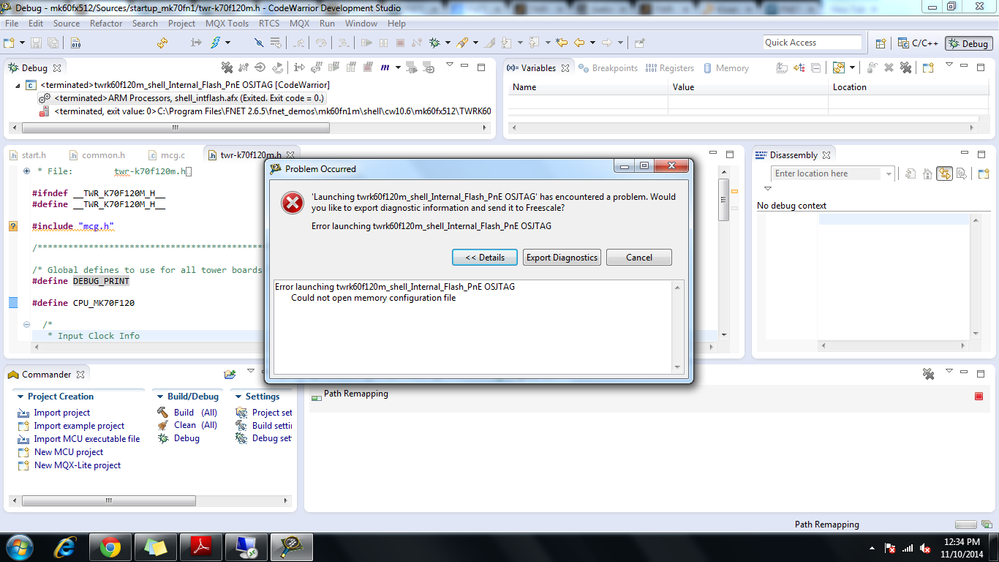

sumanv
Can any one help how to resolve the error
i.  Iam using MK60FX512 processor
ii. I downladed fnet and installed fnet on my pc
iii. I loaded the fnet_shellboot( TWRK60F120M)
iv. I did modifications in fnet_user_config.h file and i started debugging
Iam getting the above error
suman.
12,501 Views
butok
Hi Suman,
1. K60FX512 is not supported by FNET.
2. You may not take CW K60FN1M project and use it for K60FX512.
As a first step, find any working K60FX512 project (e.g. hello world), and only after that try to port FNET to it.
