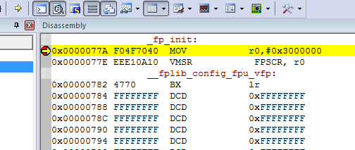

Ok, so that helped a lot, but here is where it is breaking (line 0x77E):
This is all PE code and I am not sure how to find out how to stop it.

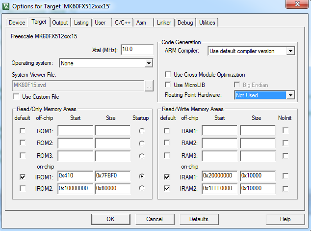

I changed my "Floating Point Hardware" to 'Not Used' and I am moving along now.
Thank you for the help.

markbishop
To use the FPU on this processor you need to do this:
SystemInit () in system_MK60F15.c
#if (__FPU_USED == 1)                   // Keil
  /* enable FPU if available and used */
  SCB->CPACR |= ((3UL << 10*2) |             /* set CP10 Full Access               */
                 (3UL << 11*2)  );           /* set CP11 Full Access               */
#endif
Version 2 – Processor Expert code:
__init_hardware() in Cpu.c
  /*** !!! Here you can place your own code after PE initialization using property "User code after PE initialization" on the build options tab. !!! ***/
//#if (__FPU_USED == 1)                   // Keil
  SCB_CPACR |= ((3UL << 10*2) |             /* set CP10 Full Access               */
//#endif
5,182 Views
mjbcswitzerland
Specialist V
I suspect that you are configuring the wrong processor type.
What chip do you actually use?
The header you have is for the K60F (with floading point unit) but the exception is due to the fact that the FPU cannot be written to.
Either your chip doesn't have an FPU or else there is something else missing that would allow it to be accessed.
Reards
Mark
5,179 Views
markbishop
I am using the MK60FX512VLQ15.
