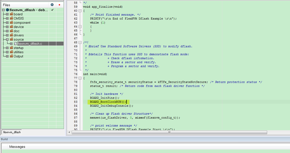

   Yes, the HSRUN mode is the root problem, just as the reference manual wrote.
   You need to change the clock mode to RUN mode.
   About the RUN mode configuration, you can refer to the SDK sample code:
Wish it helps you!

Thank you for your answer! I have my own custom project & board based on files from SDK_2.5.0_TWR-KE18F.
I suspect that the problem is that I'm using HSRUN mode. It's mentioned in the manual:
The user has no access to the Flash command set when the MCU is in HSRUN mode.
Attempts to launch an FTFE command in HSRUN mode will be trapped with the ACCERR flag being set.
Is it true that I cannot write to FlashNVM at full-speed 168 MHz? Should I first switch to the RUN mode @ 120 MHz, then write to the nvm-flash and then switch back to HSRUN?
Does the SDK have some high-level handy code or examples to easily swich on-the-fly between clock configurations?
Wish it helps you!
