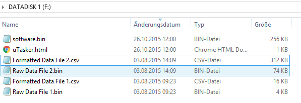

When connected to the PC host it will display some files that are in fact 'just' data in the internal Flash (that have been primed) as shown here:

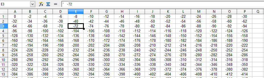

The data from the internal Flash is visible as either raw sample data (eg. "RawData File 1.bin") which can be copied from the emulated FAT virtual disk, or as comma separated value format (the data is not stored like this but instead the emulated FAT converts it on demand) such as "Formatted Data File 1.cvs" so that it can directly be opened in Excel (for example) where it typically looks something like:
