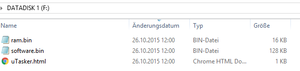

I have attached a version for a KL25 (FRDM-KL25Z) which doesn't have enough internal Flash to run the exact same reference. Instead it just allows viewing its complete internal Flash and also a (new) snap-shot of its complete internal RAM.
The RAM snap-shot is in fact quite interesting to look at because it is possible to recognise various buffers and also see the stack and heap usage. I could imagine using this quite regularly to check out the RAM usage during operation!
The file manager display it something like this:
