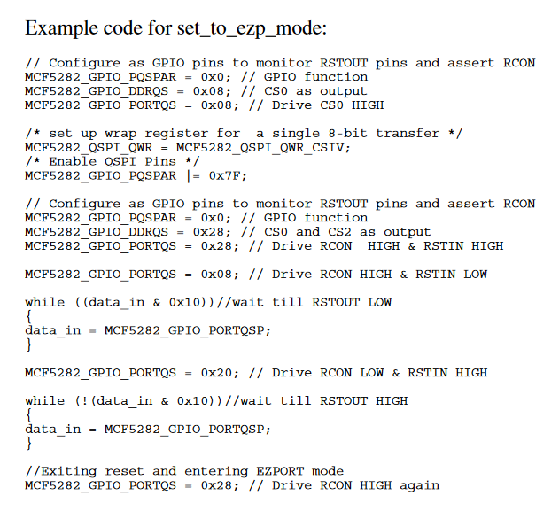

Kan_Li
Hi Alexey,
Looks like there are some steps missing to enter into EzPort mode, please kindly refer to the following for details.
and you may refer to page 91 of http://cache.nxp.com/assets/documents/data/en/quick-start-guide/KQRUG.pdf?fsrch=1&sr=1&pageNum=1  for more details.
Hope that helps,
Kan

Kan_Li
Hi Alexey,
Looks like SPI+RESET signals are not enough, the recommended process also polls the RSTOUT pin for determining when to enter the EzPort mode. Please kindly refer to the above code for details.
Hope that helps,
Kan
