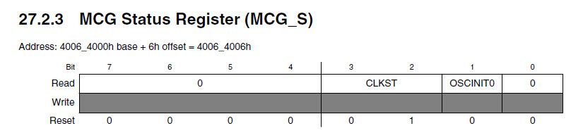

Thanks! -- this makes the reported systicks match the external clock define.  However: still no luck in the startup; I get stuck in system_MKL17Z644.c in the following
if (((MCG_C2_VALUE) & MCG_C2_EREFS0_MASK) != 0U) {     while((MCG->S & MCG_S_OSCINIT0_MASK) == 0x00U) { /* Check that the oscillator is running */     }
This is basically the other problem I have with my "seemingly working" solution I do not understand: why do I get stuck in this instruction with the the settings I have (specifically it's the HCG0 bit?!)  I can get past this instruction by setting HCO0 to 0 in the debugger and continuing.  If I leave HCO0=0, the result is that the software will seemingly linger on, -- even keep time correctly, -- however, the software, which acts as a SPI slave device, will fail to communicate.  I can toggle the HCG0 bit and it seems to directly affects the external communication; if HCG0=0, transactions fail, while if HCGO=1, I get stuck in the line above?!
I am not really happy with setting the HCG0=1 after passing the line above, as I do not understand the logic at play.  (I have not reviewed the rest of the bits in the configuration yet, but at least the reported clock frequency seems to match now!)

jaakkoeskelinen
The HCG0 bit is in the MCG_C2 register, which is visible on page 454, §27.1.2 block diagram on the lower left and described in §27.2.2 (MCG_S2) on page 436 of KL27 Sub-family reference manual , Rev. 5, 01/2016 (for the 128/256 KiB flash variants.)
(Sorry for the late reply.) The issue still persists, and actually seems even more critical than original reported.  Noticed, that after having used the ROM bootloader for a software update and reseting back, the startup code will actually once again sit in the busy loop waiting for the clock status bit (now forever.)  Practically the same sequence was used before twice (there's a separate bootloader which jumps to the actual application, both use the same startup code (separate copy.)  I.e. the clock entry routine should work when entered again.  -- this seemingly works, but I cannot really tell due to what causes this to fail here (more time has elapsed?)
Any help greatly appreciated! What to verify in this (I do not really understand the meaning of the HCG bit?)  Can crystal or supply voltage changes cause effects like this?  Is there a fire-proof way to get the external clock running (from any previous setting?)
