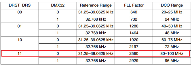

I want to run K64 core clock at 100MHz, in FEI mode using interanl 32kHz IRC.  Using following settings, how can I trim the internal slow clock to 39.0625 kHz?
I'm using TWR-K64 and OpenSDA debugger with KDS.

Hi Rini,
You can refer this: "Yes, OSDA can trim the reference of internal clock source!".
