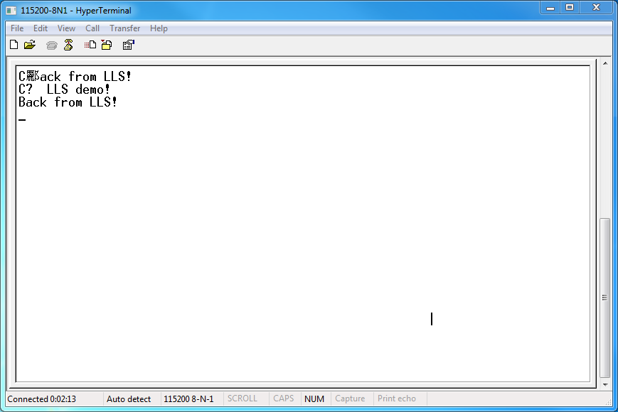

Hi All,
I still cant find a good example on how to use tsi as wakeup source / interrupt from lls mode. The real challenge for me here is configure  it using processor expert.
Does someone have an example for this.

Hi Javer Valino,
I have implemented a TSI LLS demo based on FRDM-KL26Z, please kindly refer to the following for details. The project is also attached. Please also note only TSI0 CH0 and CH14 can be used as LLWU pin, and in my demo, CH0 is used and any edge is set as the wake up event, you may change it according to your application.

javervalino
Hi Kan,
Thanks for that very useful example. :smileyhappy:
Unfortunately I cant use FEE because we dont have external clock in our board. Is this the same setup when I use FEI as MCG Mode?

Kan_Li
Hi Javer,
Yes, the low power part should be the same, you just need to change the clock configuration manually.

javervalino
Hi Kan,
Good day!
I already tested your example and it works, but unfortunately another problem arise in our hardware setup. We found out that when you use TSI0_CH0 in external pin 1 in   LLWU settings, you cannot use it as electrode in TSS_library component.
Please see below image.
Can it be solved by using the internal module 4 (TSI0) instead? Can you give an example for this.

Kan_Li
Hi Javer,
I just implemented LLS demo waked up by TSI module instead, please kindly refer to the attachment for details.
