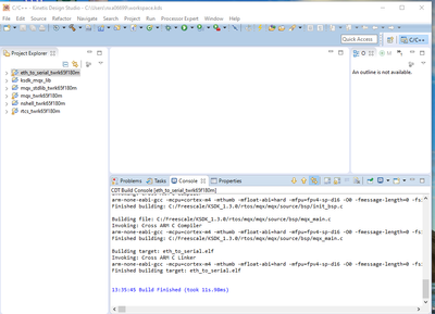

I tried to build this demo with KDS on my side, it is OK.
To build this demo, you need to build other libs first.

thanks for your reply. I forgot to include a library but now everything is included:

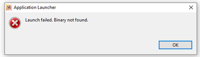

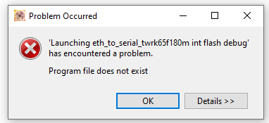

But I have another problem. When I try to debug the program I get the following messages:

It seems your compile failed.  no output.
Please check the output file eth_to_serial.elf  exists?
3,758件の閲覧回数
jill1
The file doesn't exists. I get following message in the console: "Nothing to build for project eth_to_serial_twrk65f180m".
3,755件の閲覧回数
danielchen
Please make clean and build all again

Thank you I'm now able to debug the program  and the output file eth_to_serial.elf exists.

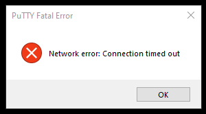

But something else must be wrong. If I try to ping the IP adress I set in the program, I don't get a response. Furthermore I tried to check the connection with putty and I receive the following error:

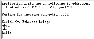

please refer to the readme file under the folder
C:\Freescale\KSDK_1.3.0\middleware\tcpip\rtcs\examples\eth_to_serial
If connection to TCP terminal is established,  all characters you input to the UART are echoed to TCP terminal and vice versa.
