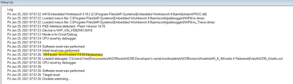

My initial attempt of downloading the bootloader to MCU was not successfully because the default setting of debugger was simulator; after this was corrected, I believe the bootloader is programmed.

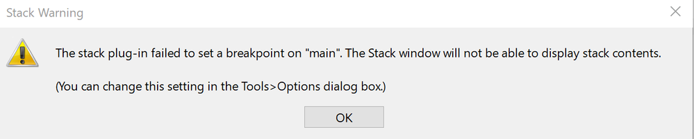

There was some warning but seems not to matter

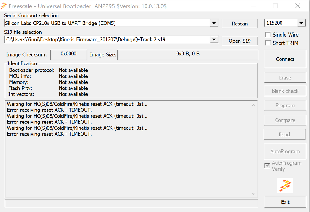

However, when I tried to connect our MCU with computer in hc08sprg, nothing is received by the computer.

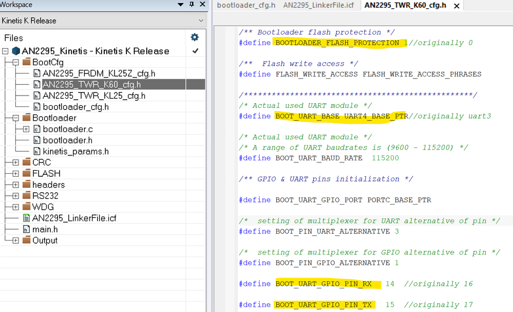

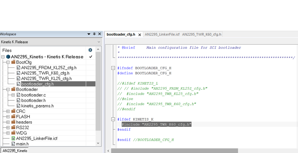

  1. To suit our case only AN2295_TWR_K60_cfg.h is included
  1. In AN2295_TWR_K60_cfg.h, UART settings are modified to suit our case, BOOTLOADER_FLASH_PROTECTION is set to 1 (according to NXP community posts)

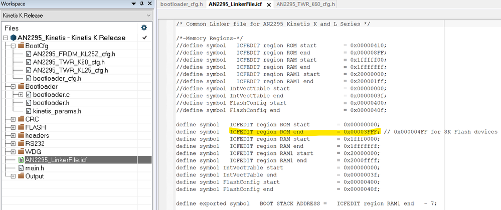

  1. In AN2295_LinkerFile.icf, only ICFEDIT_region_ROM_end is changed to 0x3FFF. (I am quite confused about how to modify AN2295_LinkerFile.icf, the modification I venture to make comes from NXP community post).

Hi Yinni,
I am assuming that you set K60_100MHz correct? Please note that AN2295 is an old software tool that is not recommended, we recommend using latest MCU boot software. You are correct that specific bootloader projects are not included in the K50 SDK, however, you can check chapter 10 of the MCU Bootloader v2.5.0 Reference Manual for porting guide. https://www.nxp.com/docs/en/reference-manual/MCUBOOTRM.pdf
You can see an example of this in this link for TWR-K60D100: https://community.nxp.com/t5/Kinetis-Microcontrollers/Port-MCUBoot2-0-0-to-TWR-K60D100/ta-p/1117267
