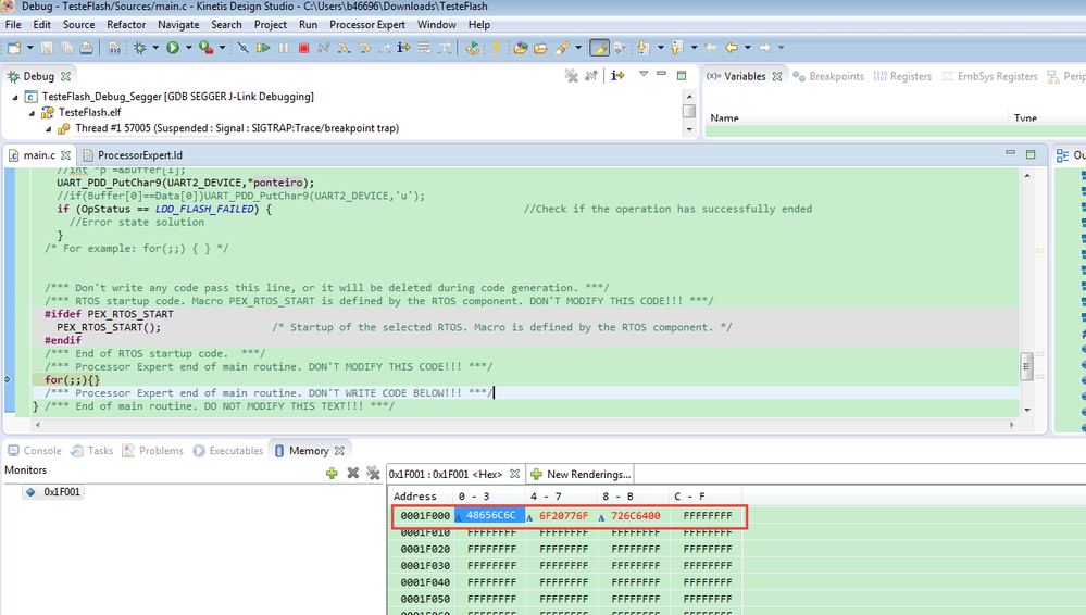

I was conducting tests with the recording in flash memory using the expert processor , and the program stopped working. I had an earlier version that was running normally but even she was not . The error is as follows: When clicked to start the program he showed PE_DEBUGHALT (); within the vector and let not run the program . I'm using kds with frdm k64f . If anyone knows of a solution I will be very grateful.

Hi Danilo,
    I run your code on my side, it works ok:
  I think your problem is caused by the 0X1F000 didn't do flash erase before, and 0X1F000 already have data.
  To the flash, when you want to write the data, you should make sure that area is erased, so normally, customer need to do the sector erase before do the flash write.
  You can do a sector erase before :
    Error = FLASH1_Write(MyFLASH_Ptr, Data, MY_FLASH_LOCATION, sizeof(Data));   //Start writing to the flash memory
  Your code can work on my side, because I do the mass erase before download the data, so the 0X1F000 is 0xff on my side before do flash write operation.
Wish it helps you!

Dear Jingjing Zhou. It's hard , worked 3 times, but when I run the fourth already gave no further . I deleted everything that had added and left as it was working yesterday and continued giving error . Even adding what you told me, the damn error persists.

Hi Danilo,
     I find you didn't add :
DataWrittenFlg = TRUE;
in FLASH1_OnOperationComplete function.
  Now I modified your code, and do the erase, write, read operation in the for(;;).
  I have test the modified project on my FRDM-K64 board, and it works ok.
   You can try my modified project on your side, I have attached it.
  If you still have problem, please let me know.
Jingjing

Dear Kerry Zhou , thanks for the help , everything is working as desired now .
