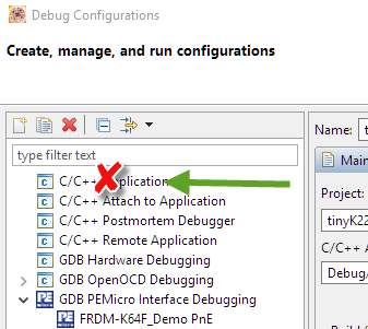

I am working with a TWR-K64F120M board and Kinetis KDS 3.2.0 software, with Processor Expert and without SDK.
I am able to create a new project and debug it ok. The firmware runs ok.
However, If I copy the project, rename it and import it, I am not able to make it work. "Error with command: gdb--version"  message shows when the project is launched.
Where am I failing?
In the first attached file I show you the way I generate the project, and in the second file, the steps I follow when I try to debug a copied project.

You are trying to debug the application on your host PC which obviously won't work.
If you check your debug configurations, you probably have created C/C++ Application ones which you can delete as they are for debugging applications on your host.
You need to create a new debug/launch configuration (select the project, then Run > Debug Configurations) and then double click on your debug connection (P&E or SEGGER) to create a debug configuration for it, and using that for debugging.

I follow your advise and now it works fine.
