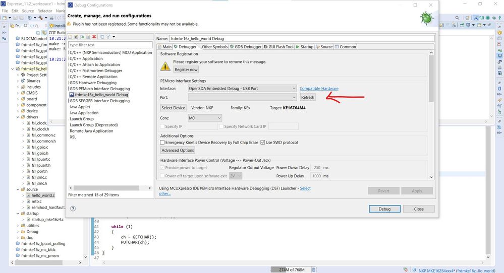

Hai,
I am facing this error while debugging any codes(sdk example and new projects). i m using FRDM-KE16z Eval board. mke16Z64VLF4 controller. Kindly help solving.
thanks,
Hari.

Hi @srihariprasad24 ,
Does pressing the 'Refresh' button in your screenshot help? If not, then your P&E debug probe is not recognized. If you are using the FRDM board with an on-board P&E firmware: make sure you are connected to the board.
If you plugin in the board, it should show up in your device manager, potentially showing up as a device on your host. Can you show a screenshot or tell us about what you see? If using Windows 10 and if your board has an old bootloader, you need to update the bootloader, see https://mcuoneclipse.com/2014/11/01/illustrated-step-by-step-instructions-updating-the-freescale-fre... and https://mcuoneclipse.com/2018/04/10/recovering-opensda-boards-with-windows-10/

Hi, pressing Refresh did not help, I have attached some screenshots. 1st one is an another frdm board that is working good and 2nd one is the one with issue.
is that COM5 from your board with the issue? If yes, the board is recognized but not as an P&E one.
What firmware did you load onto the K20 (if any)?
Does it show up as drive on your host? If so, the drive would show some diagnostic data.

srihariprasad24
FYI:
Eval board: FRDM- KE16Z
IC: KE16Z64VLF4
Software: MCUxpresso IDE
is that COM5 from your board with the issue?   YES
I m loading the sdk demo examples.
No diagnostics are shown in the drive, screen shot attached

can you upload/share the content of the two files on the drive?

Hi, here it is

I see. So you have a DapLink (CMSIS-DAP) on your board. You need to connect to it using the LinkServer debug connection (not the P&E or Segger one).

Debugging completed.
