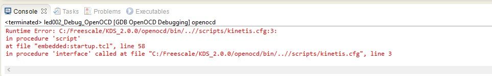

I am getting the following error while launching a simple debug for my FRDM-K64F board.
Please help as to what might be the problem. It works on my PC, but gives the error above in my laptop.

ZhangJennie
Hi Pratiek.
the error shows you connect board with OpenOCD interface,
by default, FRDM-K64F board use OpenSDA or  JLINK interface.
please
1. connect board to your PC
2. check in device manager what interface it is recognized.
3. connect the board with the correct interface.
can this help?

pratiekbhadrana
Hello ZhangJennie,
It also shows a problem with the mbed device. When I go to device properties in device manager(right click>Properties),
it shows the following message in the device status dialog 'This device cannot start (Code10)'

ZhangJennie
can JLink_OpenSDA_V2.bin work for you?
Zhang Jun
5,146件の閲覧回数
pratiekbhadrana
Sorry for the late reply. Yes it works. Thank You
