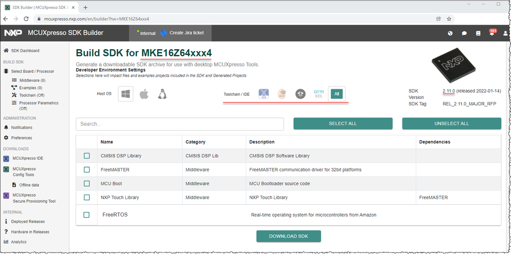

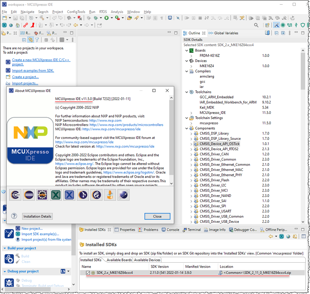

When build SDK for MKE16Z64xxx4, did you select MCUXpresso IDE or ALL? I am able to install SDK_2_11_0_MKE16Z64xxx4 in MCUXpresso IDE v11.5.0.
Build SDK for MKE16Z64xxx4.pngBuild SDK for MKE16Z64xxx4.pngMCUXpresso IDE v11.5.0 SDK_2_11_0_MKE16Z64xxx4.pngMCUXpresso IDE v11.5.0 SDK_2_11_0_MKE16Z64xxx4.png
Robin

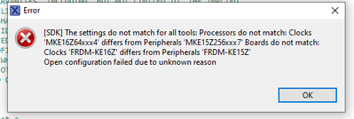

I am able to install it in MCUXpresso IDE but, I am facing an error while using config tools. I installed the SDK once again with the suggestion you gave and I selected all in toolchain option. Still, my error in not solved.
When I opened pin configuration I got the error:

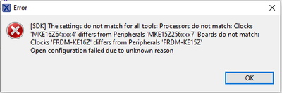

I am trying to make new project in FRDM-KE16Z64VLD4 processor SDK. Then when I tried to use pin config tools at that time I faced this error, Here, I am sharing the snapshot.

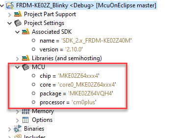

is that project created/imported from the SDK (Quickstart Panel > New project) or did you modify it in any way? I see that you have KE15/KE16 projects in your workspace, so have you copied files between projects?
You can see what device is used here:
These settings are stored in the .cproject file, while the Pins and Clocks settings are in the source files plus in the .mex file: so if you copy files from another device without the correct settings, you will get such a message.
If you created/imported an example from the SDK without touching it afterwards, then this would be an issue of the SDK itself.
