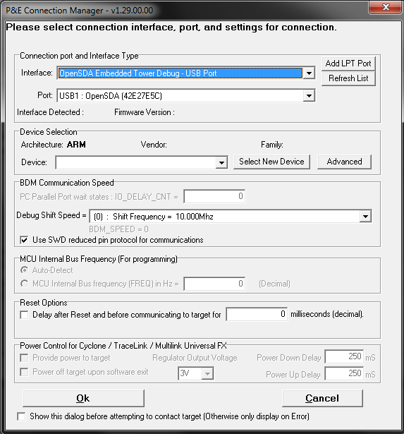

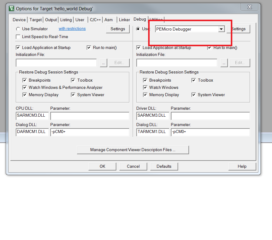

Hello. I'm trying to download a simple program to FRDM-KL25 board but I'm still getting this message:
Error: Flash Download failed  -  Target DLL has been cancelled.
I have already:
  1. intalled driver for kinetis (Freescale Kinetis OSJTAG Drivers V1.20)
  2. installed PEMicro as stated on *.pdf guides quotet on this topic: Hello everybody,when I loading program with MDK it appears unable to find device information.PE34298
  3. followed steps from a tutorial of a ARM-KEIL guy Software development with the Freescale Kinetis SDK using Keil MDK Version 5 - YouTube

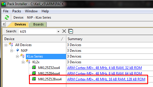

  4. selected the right MCU: MKL25Z128xxx4 since the FRDM-KL25 board has a: MKL25Z128VLK4 device.
  5. selected PEMicro on the debugger options.
  6. tried to download an example project from Kinetis SDK v1.3. (based on the video tutorial)
Then, I don't know what I'm missing. I'm attaching some images of the configurations.
Thanks for your support.

Hi Alejandro,
KL25's driver is not Kinetis OSJtag. It's PEMicro.
Please download driver and firmware form the link:
https://www.nxp.com/support/developer-resources/run-time-software/kinetis-developer-resources/ides-f...
Jing

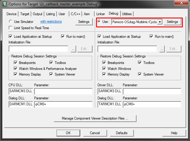

Yeah, I actually had that option available before. Let me give some extra information.
At first I had two issues:
  1. The first one is explained on following thread:  Hello everybody,when I loading program with MDK it appears unable to find device information.PE34298. There, you instructed this guy to install the OSJTAG Drivers. So I did the same.
  2. The other isuse is the one I'm explaining here.
Both: the "PE34298 error" and the "Flash error" were present at a time. After I installed the OSJTAG drivers the first error disappeared but the "flash thing error" remained. Also, the option "PEMicro Debugger" disappeared and "Pemicro OSJtag/Multilink/Cyclo" option appeared instead.
I understand that the default debug firmware on KL25 is PEMicro, and the link you gave me talks about that. Anyway, on the proccess I also tried with "CMSIS-DAP_OpenSDA.S19". I downloaded the firmware to the board with the proper procedure and then selected the "CMSIS-DAP Debugger" option on target configurations at Keil IDE. I didn't work neither. So I went back to download the OpenSDA firmware.
So you see "Pemicro OSJtag/Multilink/Cyclo" option selected because "PEMicro Debugger" is not available anymore.
Anyway, I doubt that to be the problem, just beacuse the problem was there even when "PEMicro Debugger" was selected.
Just to be clear, the board has again the OpenSDA firmware; but problem is still there.
What do you recommend?
