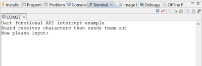

Thanks for your help; changing my IDE from Keil to MCUExpresso helped to solve my initial problem. But, now when I want to run SDKs I'm encountering a weird problem. The simple "hello world" demmo application works fine; when I debug it, the initial "hello world" message is shown on Tera Term terminal and my character inputs are echoed back to laptop. However, when I try the "UART Interrupt" driver example, nothing happens; I'm able to debug it and no error is shown, but neither the initial message of the SDK nor my input is displayed on terminal.

Hello @ElectroDesi9n ,
I'm glad to know that you have started to try MCUXpresso. Have you carried out the connection operation according to /doc/readme.txt? As shown in the following figure.

Dear @Celeste_Liu,
I've connected the laptop and board with mini USB as it was written. The configuration is as it should be; I didn't change anything. The image below shows the J2 18 and 20 are used as their ALT3 functionality. If I need to change to code or make external connection with jumper wires, I'll appreciate your help.
I have made an attempt on my side and it can work normally without the need to modify the code. For the board connection, you can refer to the following figure.
The result is as described in the readme.txt.
Please check whether your USB2COM connection is correct or not. Or you can take a photo and send it to me. I'll help you check it.

Dear @Celeste_Liu,
I hope you see this message soon or someone else help me fast. After researching and reading reference manuals I see that the "hello world" uses the debug UART and the OpenSDA so that no external hardware is required which is not the case for real world UART communications. But, my project's goal is the wireless communication between laptop and KL25Z with ESP-01 wifi module as bridge.
I want to use UART between laptop and KL25Z and ESP-01 to be able to configure ESP-01 with AT command and then establish wireless connections. But in any case, I just need some sort of wireless communication between any two devices for tomorrow. I'd appreciate your help.

I don't have any other hardware except KL25Z and ESP-01. I thought KL25Z is capable of communicating by itself. I'm confused a little bit, why do I need external hardware for this example while I didn't need anything for "hello world" demo?
I should complete my project by tomorrow, so I'll appreciate if you help me to do something with what I already have.
