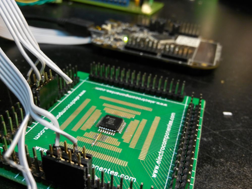

To start from scratch, a few months ago, create a project with Processor Expert for KL25Z plate using Code Warrior 10.3. I compile and debug without problems. With the same board i debug external MCU. This was a KL05Z, I read the User Guide from the FRDM KL25Z and it said it was to cut a track J11, it worked perfect, I could debug. The cable VCC, GND, SWD_DIO, SWD_CLK and RESET were connected from the FRDM towards external KL05 pin. As shown in the attached image.

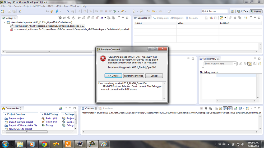

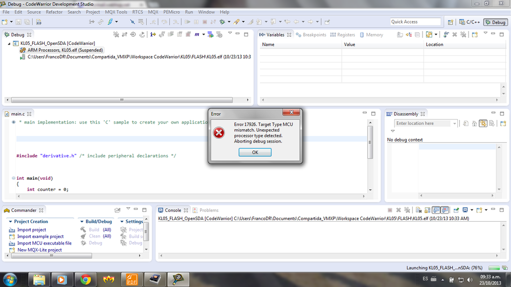

The problem begins when I try to use an external MCU, the connection is the same he had used before, the external MCU is the same (KL05Z), the problem is that the MCU does not recognize me .. Or so I think.
The CodeWarrior detected OpenSDA (I can debug the internal KL25Z FRDM), but produces the error 17926 (Picture Attached). Try installing in a virtual machine the CodeWarrior 10.3, but it gives me the same error, in the CodeWarrior 10.3 17926 Error window says, too, "Target MCU mismatch. OpenSDA debugging hardware supports only the resident target processor".
I checked all the connections between the FRDM and external MCU. Tensions are fine. The truth may be not understand that, try another FRDM KL25Z a colleague, but neither worked.

You can use the KL25Z P&E opensda to 'program' (with MSD) (not debug) another board, see
Using the Freedom Board as SWD Programmer | MCU on Eclipse
But not as production programmer, as performance will degrade over time.
If you want to debug it, you need a different firmware than the P&E one. See
http://mcuoneclipse.com/2013/04/27/debug-external-processors-with-usbdm-and-freedom-board/
Using the FRDM-KL25Z with CMSIS-DAP to program non-Freescale ARM Microcontrollers | MCU on Eclipse
Freedom Board with Segger OpenSDA Debug Firmware | MCU on Eclipse

Thanks for the reply!
I can not understand how, about a month ago, I could debug external MCU and now I can not (same FRDM).
I was watching this post http://mcuoneclipse.com/2013/05/16/freedom-board-with-segger-opensda-debug-firmware/
I could solve the problem using a OpenSDA firmware from Segger. This could debug external MCU perfectly, even more, I noticed that it is faster.
In that post is perfectly explained.

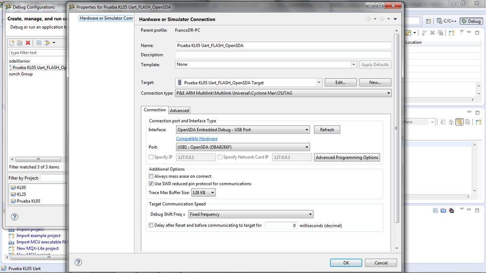

Attachment leave the Debug Configuration.
Hope you can help, thank you very much and sorry for my drafting.Config de OpenSDA.png
