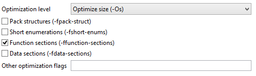

I am working with a MKE04Z8VFK4. Below code worked before, when there were no optimizations. However, now that my flash is about to be used, I have to optimize to fit all of my code in.
I am trying to erase a flash sector however, in the debugger, the CPU goes into the function for "unhandled interrupt code". Below is my code and optimization settings.

abdullahkahrama
Hello Yong,
I have just solved my problem. Actually, yes, some of the problem was because of "FTRME_BASE_PTR" which is 0x40020000. However, it should have been 0x40020005. Also, I have deleted some sections of the arm_startup file to save some code space and it seems like I have messed something up. It is now working Smiley Happy
Seems like removing following from __arm_start.c keeps the flash routine from working:

Rick_Li
Hi Abdullah Kahraman,
the problem on your side should be caused by the statement "fnRAM_code((volatile unsigned char *) FTMRE_BASE_PTR );".
When calling a function by using the function pointer, the value of function pointer should be added by 1 before calling.
suppose the address of a function in RAM is 0x1000, then, when calling this function pointer, the function pointer should point to address 0x1001.
I hope it helps!
