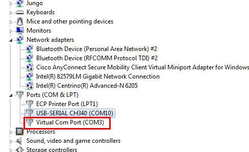

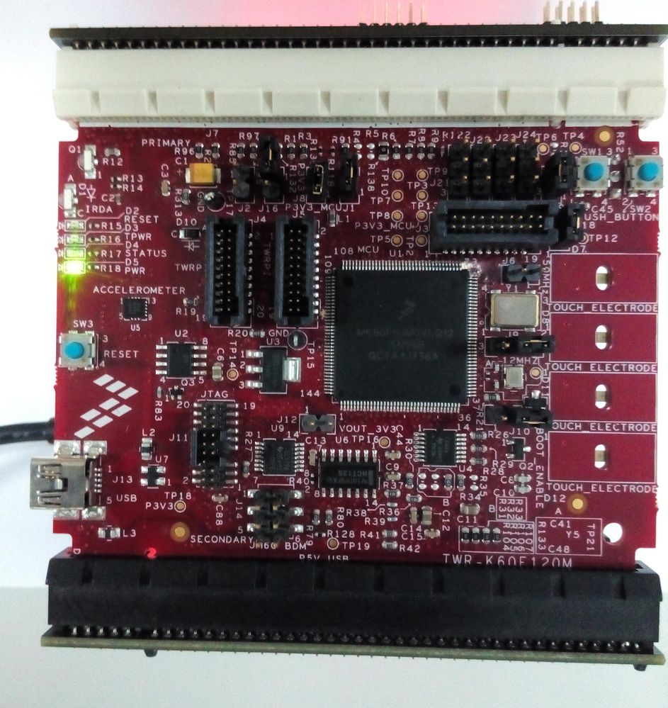

jeremyzhou
Hi Christian,
I've run the USB_CDC_DEVICSE_K60F_PEx demo on TWR-K60F120 board and TWR-SER, TWR-ELEV(Fig 1). it enumerates successful(Fig 2).
I've also used the Hyterterm communicate with the board, it still works fine too.
Fig 1
Fig 2
Ping
