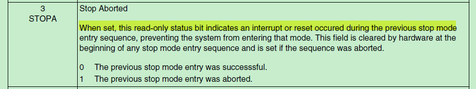

jqy
I have a problem when the power mode gets into VLPS. i found the STOPA bit is set somehow, even if I disabled all the interrupts. I am using a KL03 mcu. It seems that the stop mode is abandoned after this. The code is running at 2MHz with low power uart enabled, and the power consumption is about 200uA. I read some of the questions being asked, it seems the e8068 RTC mask issue. i tried disable it but nothing changed.
10 Replies
4,386 Views
kerryzhou
HelloJieqiu,
  1. Clear time invalid flag of RTC before entering low power mode.
     Just like what you have said that e8068, add the workaroud.
2. Did you disable the global interrupt and make sure your NMI is stable.
  Please add 4.7K to 10K external pull up resistor in the NMI pin, because the internal pull up is weak.
So you need to make sure, no interrupt and reset happens. watchdog also need to disabled.
Wish it helps you!
If you still have question, please let me know!
Kerry
