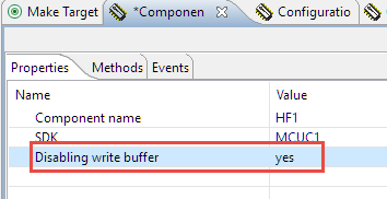

Because HardFaults can be delayed, a useful thing is to disable the write buffer. The above component has a setting for this:
Have a look at Debugging ARM Cortex-M0+ HardFaults | MCU on Eclipse  for this and other tips.
