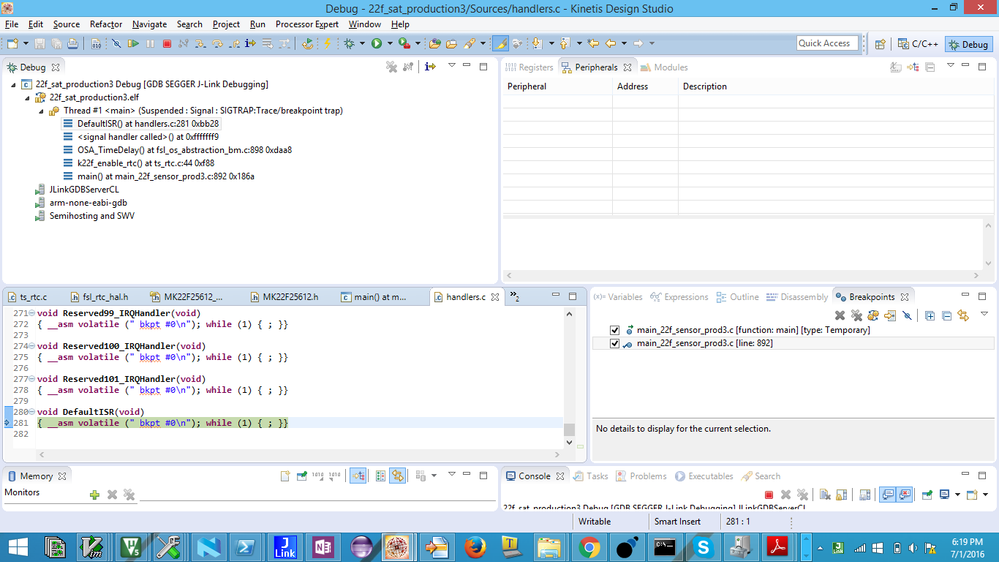

I'm trying to port my code from KSDK 1.0.0 to KSDK 1.3.0, using KDS 3.0.0.  Device is MK22FN256xxx12.
We need a precise timer in the ms, which means we can't use "OSA_TimeGetMsec()" since it's drifting too much.  In KSDK 1.0.0 we manually set the RTC registers and read them.  But when I tried to port the code to KSDK 1.3.0, whenever I write 1 to the CR OSCE it will trigger some sort of "WDOG_EWM_IRQHandler()" or Default ISR.
Seems like I'm missing something here... any help is appreciated... Thanks!

This is the result.

Hi Cecylia Wati,
    From your description, it seems you didn't enable the RTC clock gate.
    Please add this code before your RTC register configuration:
  SIM_SCGC6|= SIM_SCGC6_RTC_MASK;
  Please test it on your side, if you still have question, please kindly let me know!
Jingjing

cwati
Thank you! This seems to work.
