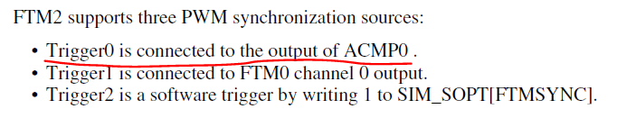

3. FTM2 three PWM synchronization function will be affected due to it was the Trigger0 of FTM2.

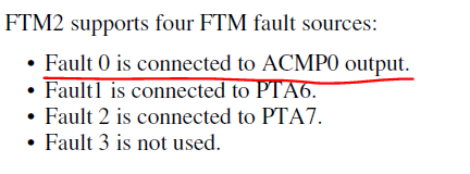

4. FTM2 fault function will be affected due to Fault 0 is connected to ACMP0 output.

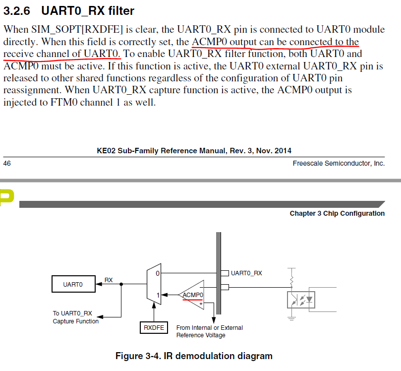

5. Then UART0_RX filter using ACMP0 will be disabled.

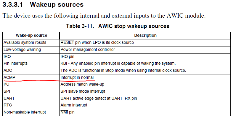

6. The wakeup function by ACMP will be affected.
