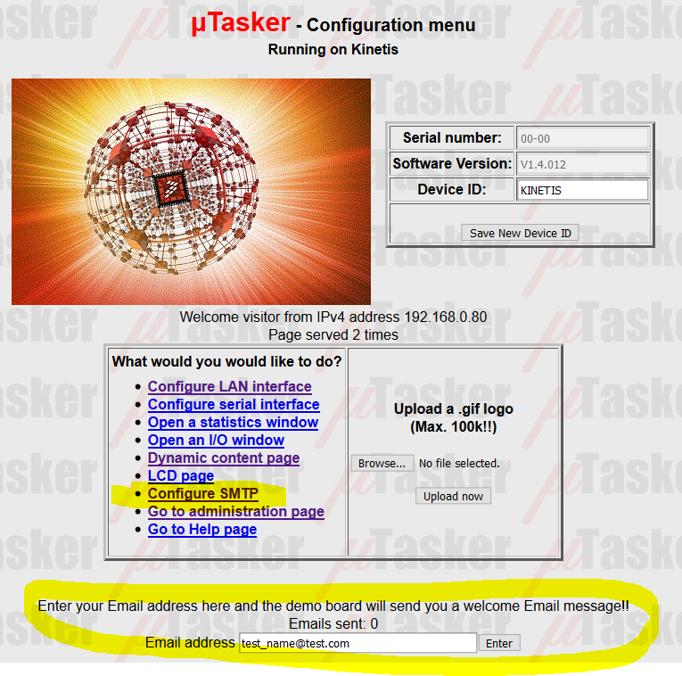

Hi André
SMTP is very simple and I don't have a tutorial specifically for it.
You can follow the Kinetis tutorial at http://www.utasker.com/docs/KINETIS/uTaskerV1.4_Kinetis.pdf which explains the web server control pages. If you enable USE_SMTP in config.h it will then include the mail support and you can send an email on the start page:
This uses either hard-coded settings:
            #define OUR_USER_DOMAIN                       "my_domain.com";
            #define DEFAULT_DESTINATION_EMAIL_ADDRESS     {'t','e','s','t','_','n','a','m','e','@','t','e','s','t','.','c','o','m',0};
            #define SMTP_PROVIDER_IP_ADDRESS              { 194,158,229,11 }
            #define SMTP_PROVIDER_ADDRESS                 "mail.provider.com"
            #define USE_SMTP_AUTHENTICATION
or you can enable parameters with
            #define SMTP_PARAMETERS
and set them up dynamically on the SMTP page.
You can test in the uTasker K64 simulator and set break-point in the SMTP file to get to get to know any additional details as required.
Mark

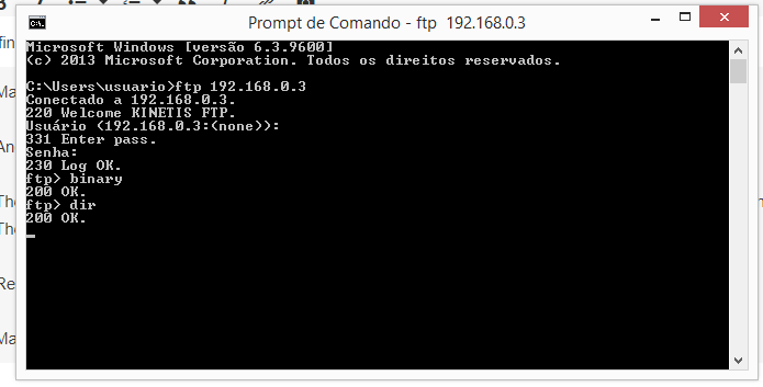

andréluis
I define ETH_INTERFACE and USE_TCP. But when i send dir to FTP command, he block. If i use FireFox or FileZilla i have the same problem.Sem título.png

mjbcswitzerland
Specialist V
André
I just tested the Open Source version on a FRDM-K64F and didn't have a problem:
D:\MJBC\temporary\>ftp 192.168.0.3
Connected to 192.168.0.3.
220 Welcome KINETIS FTP.
500 What?.
User (192.168.0.3:(none)):
331 Enter pass.
Password:
230 Log OK.
ftp> dir
200 OK.
150 Data.
-r Empty
226 OK.
ftp: 13 bytes received in 0.04Seconds 0.32Kbytes/sec.
ftp>
ftp> quit
221 Bye
(this is with empty uFileSystem rather than SD card).
Could you try loading a reference from here to check its behavior?
http://www.utasker.com/kinetis/FRDM-K64F.html
Note that the FTP data connection (which is failing) uses a random TCP port and you may have a firewall issue with this (temporarily disable the firewall in the PC to check). Also record the traffic using Wireshark so that you can see what happens exactly.
Mark
