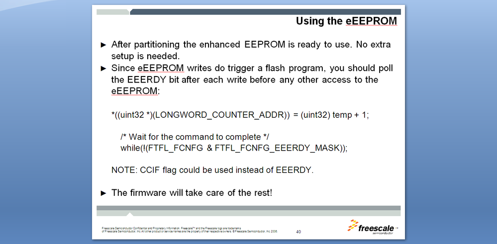

Kan_Li
Hi Joginder Rana,
I think maybe you have to check the EEERDY bit after every write. Please kindly refer to the following for more details.
Hope that helps,
Kan

joginderrana
Hi Kan,
First, thanks for your support. I tried the process you suggested but it did not work.
