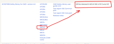

Hi Everyone, I am trying to find the IEC60730 Safety Library for NXP MKE1xZ Series of Micro-controller.
Earlier this was available as separate download, but recently as per the below mentioned link, this should be a part of the SDK Package.
https://www.nxp.com/applications/enabling-technologies/functional-safety/iec-60730-safety-standard-f...
I downloaded the SDK version 2.16, but couldn't find it, can someone please help where can i find them?

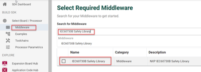

For KE1xZ devices we have 4 evaluation boards: FRDM-KE15Z, FRDM-KE16Z, FRDM-KE17Z512 and FRDM-KE17Z. And just the FRDM-KE17Z512 has the IEC60730B Safety Library in the SDK version 2.16.000.
However if you look for Middleware in MCUXpresso SDK Builder you can find all the SDKs that contains it.

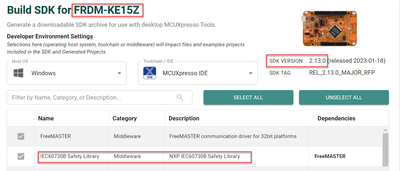

And for example, FRDM-KE15Z has this Middleware, but in SDK version 2.13.0:
And apology for the confusion. And hope it helps you.
