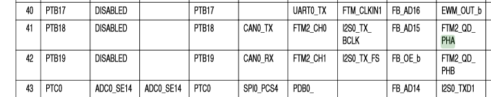

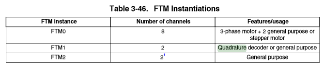

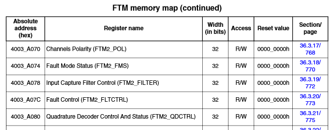

The K22 pin map indicates FTM2 support for  quadrature encoders because it lists FTM2_QD_PHA and FTM2_QD_PHB.  The reference manual's FTM memory map refers to FTM2_QDCTRL.  But Table 3-46 says FTM2 is general purpose only and 10-16 seems to imply the same.  Can anyone clarify these seemingly-conflicting pieces of information?

The first file is applicable to the K22_50, however the second for the K22_120.
The two kinds of MCU actually contain different peripheral and I think you mixed up them.

dave408
Senior Contributor II
Thanks, Ping.  I wasn't careful enough.  I eventually found the matching datasheet and reference manual (confirmed with the exact part number on the title pages).  It's just that the links I was following before would take me to a page on Freescale that had a lot of processors and I picked the closest one I could find.  I can find the links on google, they are just a little farther down.  User error!  :smileyhappy:
