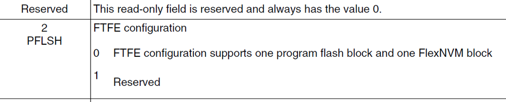

I want to take advantage of the P Flash swapping mechanism that is mentioned in AN4533(Robust Over-the-Air Firmware Updates Using Program FlashMemory Swap on Kinetis Microcontrollers).  I found this App Note from section 17.7 of the KE1xF manual, which leads me to believe that the MKE18F512VLH16 supports this.
Reading through the app note, it says that a device needs to have at least two P Flash blocks, and swapping capabilities.  The KE1xF manual mentions that the device has 2 256KB blocks in section 13.2.2.
However looking at the PFLSH field in the FTFE_FCNFG register, it says that the only FTFE configuration that you can have is to support one program flash block and one FlexNVM block.
I am very confused as to why the manual would reference this app note if I did not even have the ability to do this in the first place.  I also do not see the FTFE FCCOB0 command for swapping (0x46) in the KE1xF manual.
I am just looking for some clarification on whether the MKE18F512VLH16 supports P Flash swapping.  I have two P Flash blocks, and the reference manual refers to this app note.  However, I can only support one P Flash block, and have no reference to the command in the manual.

Hello Sean,
As you mention, this application note shouldn't be there. For example, if you check the reference manual from the K24 this has a Swap Control command that it's mention in this application note.
I will report this to the applications team.
