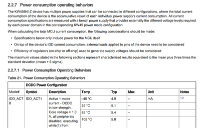

Also what is the current consumption of this Microcontroller

For power consumption, you can get it in datasheet. Take KW45 as an example, please refer to the KW45B (radio) and KW45Z (MCU) Data Sheet
