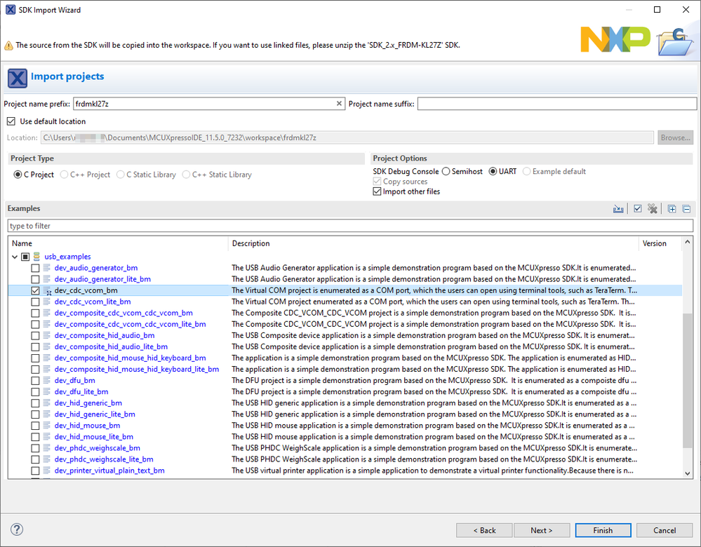

You can refer the USB examples in SDK:

What about the CDC VCOM example is not working?
That is the USB UART equivalent.
It is up to your application to translate the I2C data to the CDC message to get it sent out USB, just as it is up to the application to translate I2C to the semi host console.

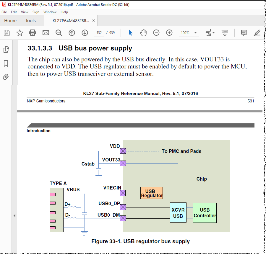

Please show us the schematic of your custom board. Does the circuit of your custom board same as FRDM-KL27Z or the "33.1.3.3 USB bus power supply"?
If your custom board same as FRDM-KL27Z, then you just need to switch from semihosting to UART, please refer: MCUXpresso IDE and Semihosting.
If you don't want to output the data through UART(using externa UART-2-USB adapter), only want to data output through USB0_DP and USB0_DM then you may need to migrate the I2C example to USBCDC example.
