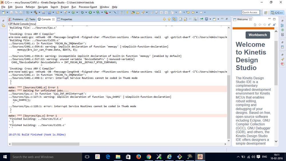

Thank you Erich It gave me a lot of insights. I want to import a code Warrior project to KDS and I encountered this error
Can you tell me the reasn for it?
8,263 Views
BlackNight
I general, I recommend to create a new project with the wizard and then add your source files to it. Much easier, simpler and usually the way to go.
As for that error, see the description about it in Kinetis Design Studio: Migrating KDS V2.0.0 Projects to GNU Tools for ARM Embedded (Launchpad, KDS V...
I hope this helps,
Erich

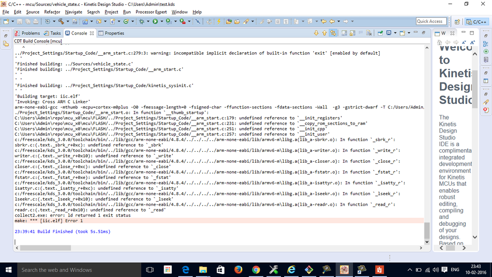

Hi Erich,
             Ya that is the way to go by creating a new project and importing source files but i want to know the reason why i am not able to build eventhough i followed the same steps as in the above discussion link given by you and I also followed a document for importing a codeWarrior project into KDS.This is the link for that document http://cache.nxp.com/files/microcontrollers/doc/user_guide/KDSPUG.pdf?fpsp=1&WT_TYPE=Users%20Guides&...
I want to understand the problem and things behind it instead of just considering it as a black box.I got an error message saying "ld returned 1 exit status"
which should go off if I include librt as per the document but it didn't can you help me out in finding the reason and solution for it.
8,263 Views
BlackNight
Hi Vignesh,
see the same document Kinetis Design Studio: Migrating KDS V2.0.0 Projects to GNU Tools for ARM Embedded (Launchpad, KDS V... about semihosting. I think you have not set the no-sys option?
Erich

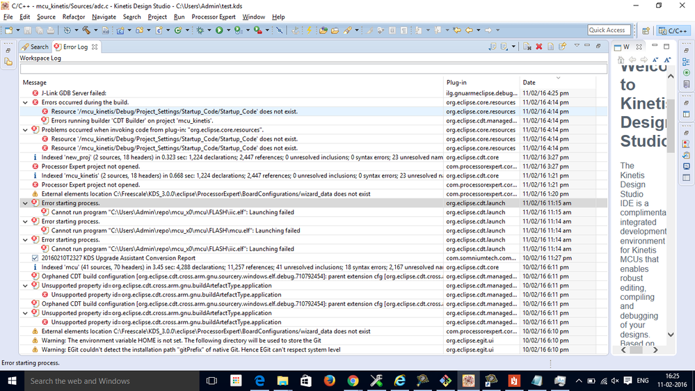

             My project is build but I am not able to run it.The error log showed these messages.
Can you help  me the reason for it and how to fix it?
8,263 Views
BlackNight
The 'orphaned' messages in your problem view are telling me that you are not using a KDS project (maybe you are using a CodeWarrior project, or from the message as well a CodeSourcery project).
Please make sure your project is a KDS project.
I hope this helps,
Erich

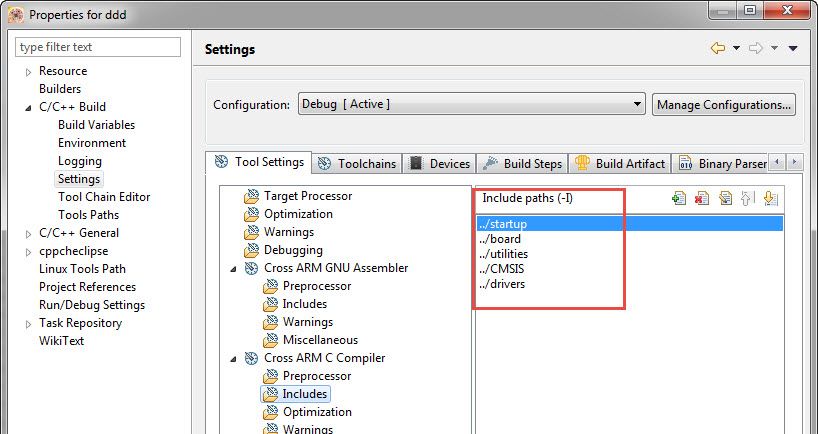

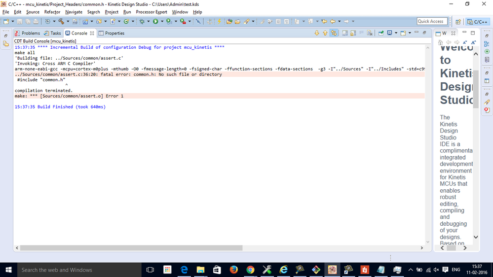

             I followed your same steps by crating a new kds project and copy pasting the same source files but I got an error like this while building.
Eventhough the commom.h file is there it is throwing an error like this???
8,263 Views
BlackNight
You need to specify the directories where the compiler can find the header files, like in the example below:

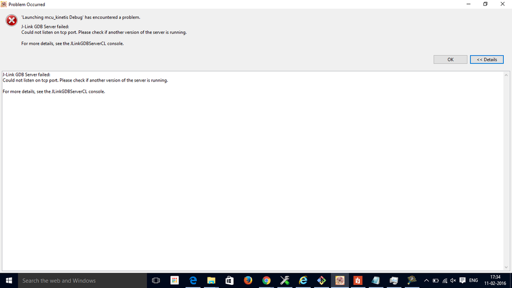

             I did the changes suggested by you.Now I am able to build the project but I am not able to Run or Debug it.It shows me these error messages.
It is throwing me an error message like this.How to fix this???
8,263 Views
BlackNight
I suggest to follow the advice in that dialog box.

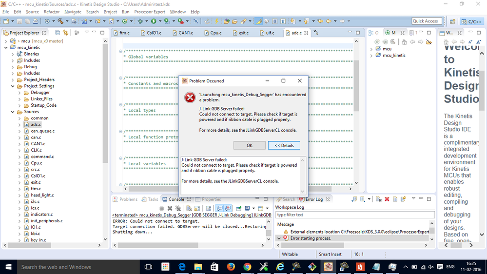

                   I fixed that problem.The cable was causing it.But now I am able to comfortably bebug or flash in CodeWarrior but not in KDS.It is showing a dialog like this.
Can you tell me how to fix it???
8,263 Views
vigneshbalaji
Senior Contributor I
Hi Erich,
             I checked the connection.It is proper.I am able to Flash code From CodeWarrior with the same connection???

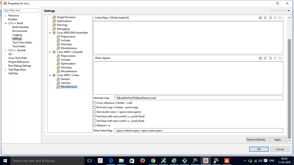

                           I am able to build it now.I added the new library nanolib using --specs=nano.specs and then I added the semihosting -specs=rdimon.specs.I have attached the screenshot of it.

Please tell me where to add the Linker options???
8,263 Views
vigneshbalaji
Hi Erich,
             I got to know that it is because of semi-hosting.where to give the instruction -specs=rdimon.specs.Please tell me where to make changes to execute semi-hosting?
