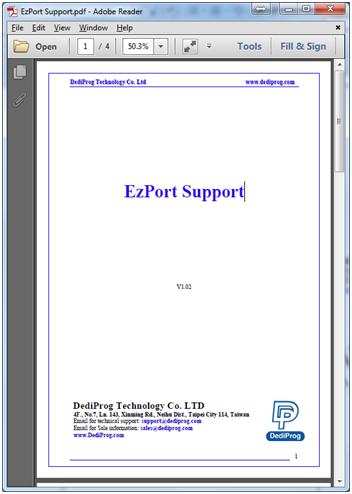

I've purchased a SF600 Plus programmer and below are my notes on setting up the hardware and software.  I’m following the directions provided by DediProg on setting up EzPort in the EzPortsupport.pdf document.  Unfortunately, the directions are a bit vague and I’ve been unable to get the programmer to work.

EzPort_Support.pdf
This document contains set up info to Program and I hope Read Freescale MCU

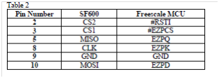

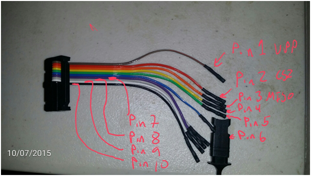

Hardware Connection Table
Connecting SF600 to K64 chip via SWD connector on my board.  Below are connection details
Table 2 from DediProg EzPort user manual for SF600
K64 pins vs SWD header on board vs SF600 DediProgammer pinout

SF600
Pin
Name
SF600 Pin #
SF600 Split Cable Color
Comment

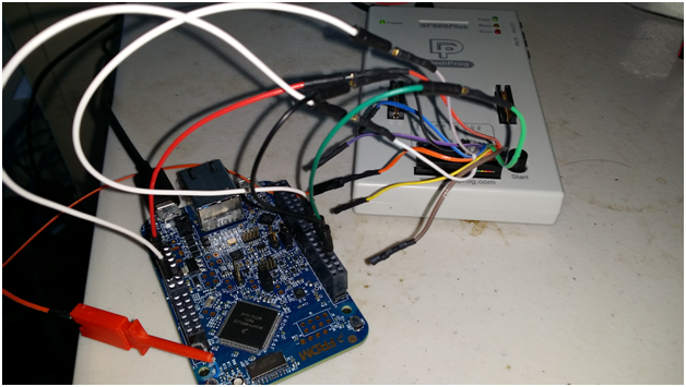

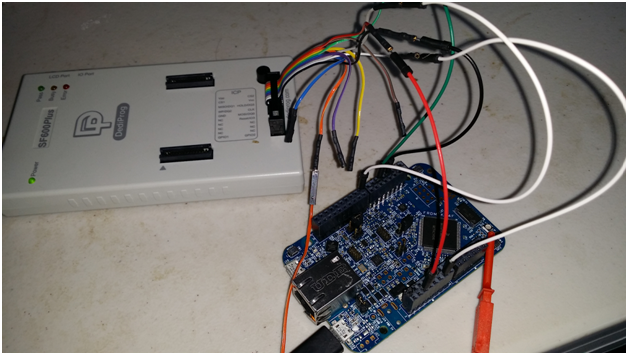

Connecting Dediport to Target FRDM-K64
Most of the connection points required for EzPort on the FRDM-K64 board are exposed on the Serial Wire Debug (SWD) connector and on the Ardinuo headers.
The SWD connector is used a segger j-link to load and debug software.
Before connecting the programmer to the FRDM-K64, scratch out the trace jumper at J11 and install a two pin header.  Leave the jumper  J11 open.
This cuts the clock signal from the OpenSDA circuit to PTA0 (SWD_CLK/EZP_CLK) of the K64 processor.
DediProg Split Cable – Note Pin 3 – Orange is CS1 NOT MISO as shown in the picture

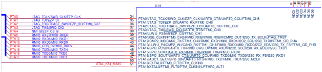

K64 Pinout for PT0 – PT4 lines which are used for EzPort with Reset Line

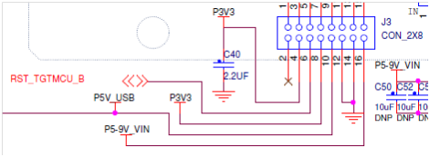

PTA0 (EZP_CLK) (pin 34 k64) is on pin 2 of J2 (2x10) -  Gray Wire on DediProg Split Cable
PTA1 (EZP_DI) (pin 35 k64) is on pin 8 of J1 (2x8)   Black Wire on DediProg Split Cable
PTA2 (EZP_DO) (pin 36 K64) is pin 12 j1 (2x8)   and   on pin 6 of SWD connector  - GREEN Wire on DediProg Split Cable
Reset Line (pin 52 on K64) is on pin 6 of J3 (2x8)  - red wire on DediProg Split Cable
Gnd are pins 12 and 14 on J3 (2x8) White on DediProg Split Cable

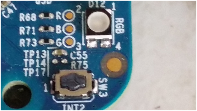

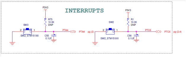

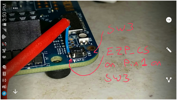

EZP_CS – which is also NMI line – PTA4 – connects to SW3
PTA4 (EZP_CS_B) (pin 38) is connected to SW3  - Orange Wire on DediProg Split Cable
Note: on rev D1 board/schematic – R75 is DNP (do not populate) – so should not be too hard for the SF600 programmer to pull PTA4 (EZ_CS) low with just a 0.1uF cap on the line.  Pulling the EZP_CS line low is how the K64 is put into EzPort mode.
On the K64, the SWD/JTAG pins and EzPort pins are multiplexed on the processor. The state of the EZP_CS signal is sampled at reset to determine whether the SWD/JTAG pin functions or the EzPort pin functions are enabled on the pins. If EZP_CS is high at reset, then SWD/JTAG functions are enabled on the pins. If EZP_CS is low at reset, then EzPORT pin functions are enabled.
Note: I’ve installed a wire on pin 1 of SW3 that connects to the Orange Wire on Split Cable – CS1
All the other signals were accessible via the Arduino connectors.
Below is what final wiring looks like.
Its a bit of a rats nest, but I've verified all the connections so pretty sure its NOT a broken connection problem.

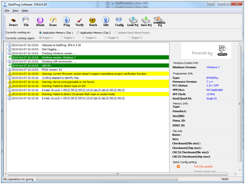

DediProg Engineer Software Set up
These are the directions for EzPort Set up document.   I’ve followed them and tried various alternatives.  No option seems able to detect the part type – nor read the part’s memory.
  1. 1.) Open DediProg Engineering software.
    1. a. Click on Detect and select Freescale part number – Note: No K64 part number but K61, K60 and K70 part numbers
Do I pick K61FN1M0 or MK64FN1M0 or K70FN1MO – which all seem to have 1M of flash?
I picked MK61FN1MO  - DediProg has indicated this is a valid choice.

When I hit detect button in software, DediProg does NOT detect part type. It seems to try to reset board, but it doesn’t seem to recognize K64 part.
When I manually input K61, K60 or K70 part, I still can’t read K64 memory.
10/13/2015
Installed new beta software – no change really
All attempts to identify the chip fail.
I’ve also tried the edit button (read the chip) but they also fail.
