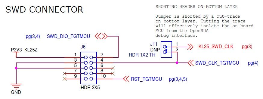

Please tell me the debugging method of KL25Z using SW.
Is the following procedure all right?
1.Cut the trace of J11 pin1 and J11 pin2.
2.Conect SW_DIO and J6 pin 2.
3.Conect SW_CLK and J6 pin 4
4.Conect GND and J6 pin3 or J6 pin5.
I tried it, But did not get along well.
Please tell me whether an upper procedure is right .
(The debugger is ULINK2)

Hi, Tonogai
You can have a try to conect SW_DIO and J11 pin 1 not J6 pin 2.
Hope my reply can help you.

norikazutonogai
Hi, Tian
Thank you for  replying.
I tried to conect SW_DIO and J11 pin 1, but My debugger was not able to recognize the SW divice.
What is wrong?. I invetstigate it.

PatriciaTeran
Hi, Norikazu
Sorry for the late response, are you still having the same issue?
