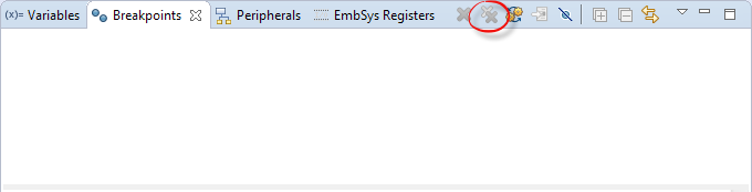

I have an heavy debug issue with a custom designed KEA128 board:
After starting the debugger I'm not able to step through the program (F5 or F6). I'm using the PE Multilink Universal Debugger and the S32 Design Studio with PE plugin. On other workspaces and the same toolchain the debugging works flawlessly. I'm running into a similar issue if I try to debug this workspace on a TRK-KEA128 evaluation board via OpenSDA. So it seems this issue has something to do with this projects workspace.
Here is what I'm getting in the console windows:

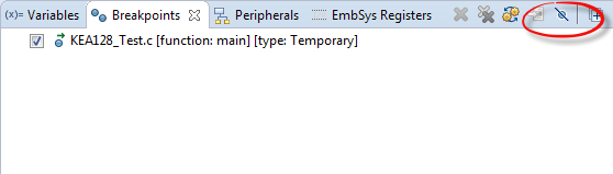

Hi 0815,
Please make sure you didn't select "Skip all breakpoints" button:
And then try removing all breakpoints and setting a new one.
Hope it helps!

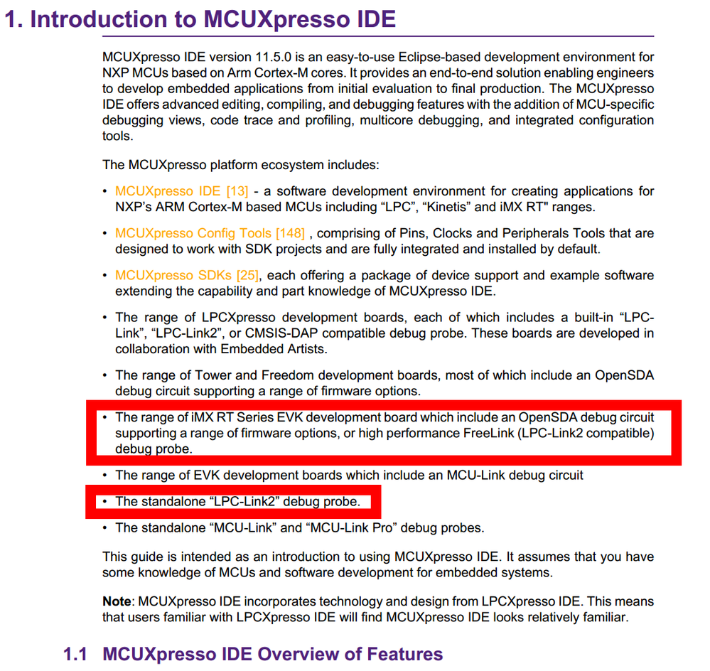

Lukas_Frank
Senior Contributor I
Hi Dear @Carlos_Mendoza ,
I used internal boot mode as you mentioned. But I think the issue related with my debug configuration. I am using J34 in EVK. But I think I need to use LPC-Link2 Debug Probe for debugging with J34. Could you please clarify me about Am I able to debug with J34 or not? Because reference manual says below and I thought that I will be able to debug my card with J34 if I use FreeLink Interface's JTAG connector. Does this JTAG Connector supports debugging?
First Clue:
Second Clue:
Thanks for your help.

0815
You are right, it is embarrassing. :smileyblush:
