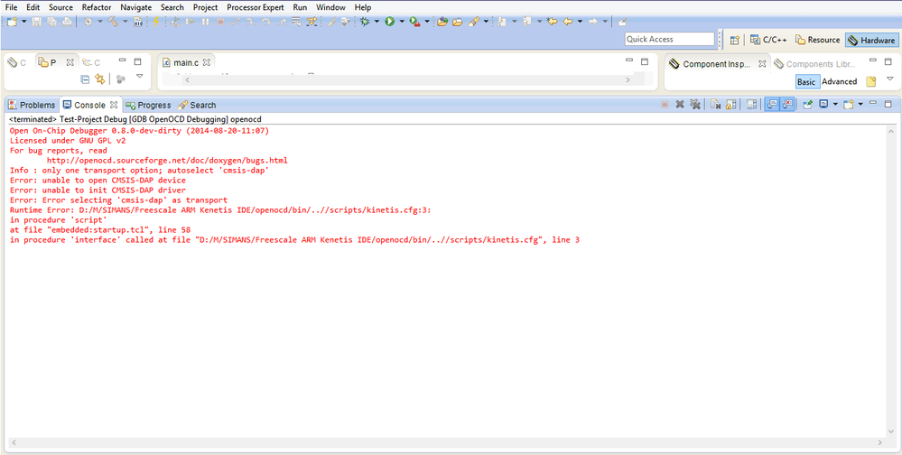

I have setup the debug configuration as this document, "Kinetis Design Studio v1.0.1 Quick Start Guide" says but still shows me these Errors,
any comment or recommendation on what I must do.

Thanks for your comment and consideration. That what I have exactly tried but it didn't work! I am using Freedom board and I was wondering for debug I should select P&E USB Multilink Universal or "GDB OpenOCD Debugging". I know that the OpenSDA is from P&E but I am not sure which option I should select. I think that could be one of the reasons it shows debugging error.
I thought this must be very straight forward process on the KDS IDE or setup for Freedom boards. I have to try all the possible options. Any comments and advises are welcomed.

1)  Press and hold the Reset button (SW2), Plug in a USB cable (not included) between a USB host and the OpenSDA USB connector (labeled “SDA”).
2)  Release the Reset button.
3)  Copy & paste or drag & drop the "DEBUG-APP_Pemicro_v108.SDA"  ( in here " C:\Freescale\KDS_2.0.0\pemicro\opensda"  )  to the BOOTLOADER drive.
4) Unplug the USB cable and plug it in again.
5)Then debug , choose GDB PEMicro Interface Debugging .

Thanks for the advice. I found the issue. Provided User Guide Document is not really made properly. It was totally misleading. It says:
(a) If you are using the on-board OpenSDA debug interface running the mbed projectCMSIS-DAP firmware then right
click on GDB OpenOCD Debugging and select New to create a new debug configuration. This configuration will use
the OpenOCD (Open On-Chip debugger) GDB server to interface with the target.
(b) ...
(c) If you are using a P&E USB Multilink Universal or USB Multilink Universal FX debug adapter, or if you are using the
on-board OpenSDA debug interface running the P&E firmware then right click on GDB P&E Interface Debugging
and select New to create a new debug configuration. This configuration will use the P&E GDB server to interface
with the target.
Of course most people will go with (a) which is wrong and (c) is the correct one for whoever uses Freedom board. I selected that and it worked.

Hello Space4 Embedded:
Just to provide some clarification about you comment:
Not exactly. Using a Freedom board does not mean you have the P&E firmware. The first Freedom boards as yours (FRDM-KL26Z) had a P&E proprietary OpenSDA firmware. Latest Freedom boards (e.g. FRDM-K64F) come with a new version of OpenSDA usually called OpenSDAv2, and the default debug application is CMSIS-DAP. That is why the guide document lists this as the first option.
For details you can check the next document in the community: OpenSDAv2.
Regards!
